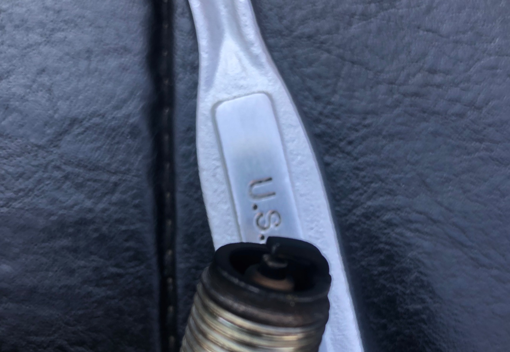

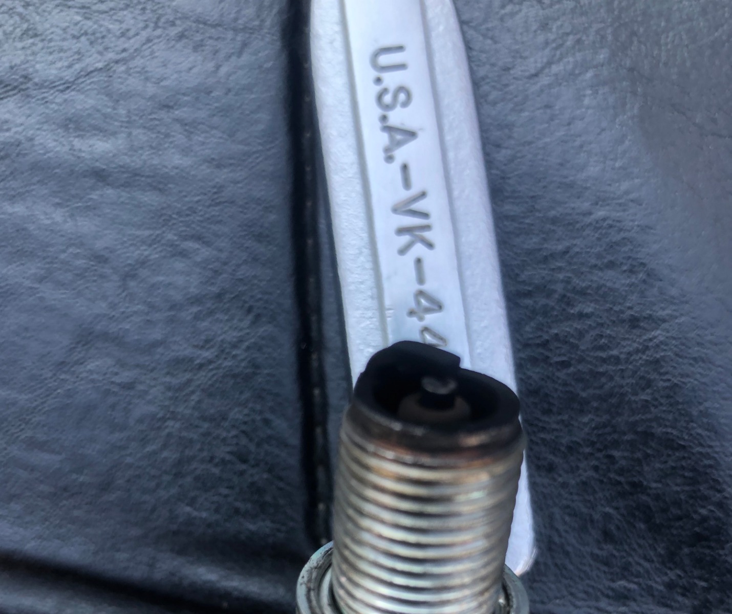

09 Mar 2019 13:15 - 09 Mar 2019 13:16SWest wrote: Being even I meant one arm isn't lower or higher than the other one on the same float. Easiest way is upside down. As for the rest I agree.
Plus 1 through 3 look like this. Plug 4 is normal. This is the set that is already on the bike, not the new, vapor blasted set:

Looks lie you're burning a little oil but not fouled. When I was fouling plugs they would be bridged and not fire. I ran BP8ES plugs with a deeper reach. Also I ran leaner pilots to burn the oil. That worked better but I was going through a lot of oil. Viton valve guide seals cured that problem.

Im not losing any oil. The plugs have carbon all over them, not oil. Its carbon fouling. Popping in the exhaust and all the signs of a rich condition.
Anyways, if it is the value guide seals, what is the fair market rate to have them repaired? Whats involved? I dont have the time to do this. I would have to pay someone.

Popping is usually a lean condition. Your carberation may be way off up and down the RPM range.

09 Mar 2019 14:03 - 09 Mar 2019 14:18SWest wrote: Popping is usually a lean condition. Your carberation may be way off up and down the RPM range.
Which could account for the condition of the black and sooty plug right?
How can the plugs be black (rich) and Im hearing popping (lean) which should result in white spark plugs? Im thinking the carbs are all jacked up.
A friend said this could be a spark issue as well.
