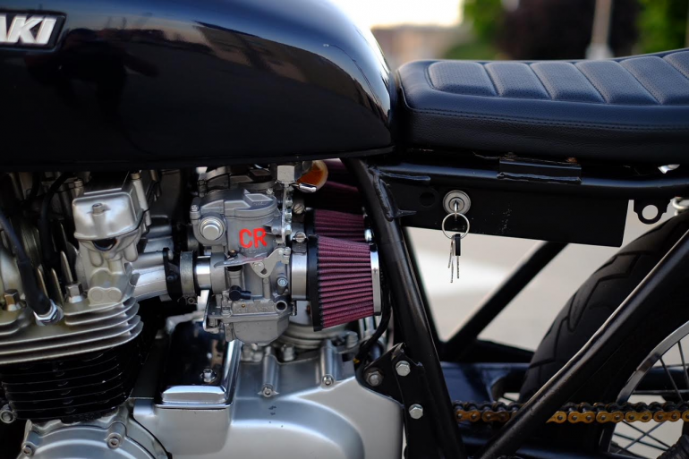

What do you think about my son's idea of getting New CR Keihin 29 carbs?

Too big for a non modified 650.

Remember, no more baffle on the bike, so a lot more air now. 29's may be OK
from this forum:
www.kzrider.com/forum/3-carburetor/51576...-cr29-for-street-use
"math would tell u that 29mm carbs r too big for a 650cc motor, but guys do it and come away with a smile.
there r guys hear running rs34'd on kz810's and report good results. i run them on my 1200cc kz.
1 thing about buying used aftermarket carbs, is that u will never loose money if u sell them later.
generaly speeking, carbs r like cams. if u increase the size of the carb/cam , u gain top end and loose bottom end.
so keep that in mind. if u like ripping back roads and drag raceing, bigger is better. if u like doing wheelies smaller is better."
from another
This gentleman put them on his bike. Says it runs like a dream. He wrote
"I did not ever get the VM24s to run right, even after multiple rebuilds and tunes. I can say that the CR29s are amazingly smooth but if you open them up it’ll scream! I notice that the throttle response is crisp and that it just wants to be ridden fast haha."
www.dotheton.com/forum/index.php?topic=72678.0
Last edit: 09 Mar 2019 16:21 by WarrensKZ.
- baldy110
- Posts: 2272
- Thanks: 512
Re: He said these carbs were perfect for my bike. I was not so smart
09 Mar 2019 17:23
He's lying, no way is he getting 29's to run right on a stock motor. The VM24 is a good carb and once dialed in runs great. Put the baffle back into the exhaust, set the floats using the wet method, install 17.5 pilots, 102.5 mains. Make sure all the maintenance has been done. Make sure there is 12 volts at the coils. The bike will run good.

The baffle wasnt part of the problem. It was only taken out today. Me and my sons like to make noise (they have KZ's as well) so the baffles stay out. I will have a second think about the CRs. Such a mixed reaction on them. When I did a search here in the forum, lots of posts from 2012 that say the run great.

Its likely kawasaki knew a little more about capacities and carb sizes than some internet forum guy. Z900's and z1000 had 26's on them. When khi bought out the z1 to create the best and fastest road bike available at the time if they could have got better performance from bigger carbs do you not think they would have used them given their aim to blow away the market. Hell, they even held back two years and increased the capacity from 750 to 900 because Ho da beat them to market with the cb 750.
Listen to what the guys are saying, get the 24's set up correctly for your bike and you wont be disapointed.

Yes I think I will forgo the CR's. My sons and all their youthful energy is infectious.
One of them said "if you dont get CR's you must get pods." These boys dont quit. Final decision, im going to find out what is going on in the carbs to make cylinders 1-3 foul plugs (but not 4 strangely enough) and get this thing running right.
