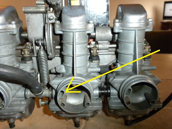

Those carbs with the blue on them did come off a road race bike.
Bought the carbs used for a good price.
Should be VM24SS I believe, don't know as they came with a bunch of parts I bought.
Think the blue is to prevent the drain screws from coming loose, I don't know.

Just in case, here's a pic of VM22SS carbs. VM24SS carbs do not have the orifice at the 10:00 position that the VM22SS carbs have. Ed
