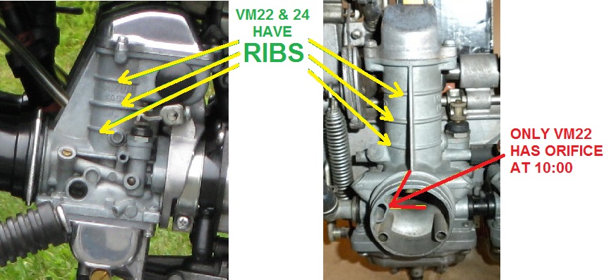

Those are the stock KZ650 carbs. If the bike is a 1978 KZ650-C2, KZ650-B2, or KZ650-D1 they are Mikuni VM24SS (24mm) carbs. If the bike is a 1978 KZ650-B2A or KZ650-D1A they are Mikuni VM22SS (22mm) carbs. The easiest way to tell the difference between the two different carb types is by the presence or absence of the orifice at the 10:00 position of the intake mouth side as shown below. Ed

Got the carbs out. Pretty easy actually. No 4 Intake insulator was actually loose and I could move it easily by hand. I took it off and cleaned both surfaces and looks clean so I put it back on and tightened the screws! All of the others were tight and surprisingly in good shape. I have the orifice so these are VM22SS.
