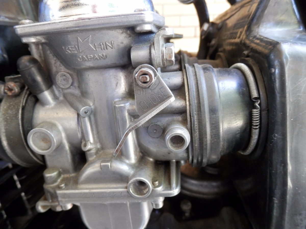

This is the 5th KZ I've owned and I always find it difficult to remove the carbs but this one has me stumped. The air box doesn't seem to be bolted on in any way that I can see. Now I can probably remove the carbs with the air box and boots in place but I'm wondering is that right?
At this point I can try to force the carbs out past the boots or remove each boot individually then pull the carb rack. It looks like I may have enough room if I push the back of the carb rack down under the boots while I'm removing them from the intake insulators.
Any suggestions?

One each side of the airbox near the back you should find a little "L" shaped bracket that secures it to the frame. If you remove the bolts that hold those brackets to the frame you will be able to move the airbox rearward a tiny bit; not much,but every little bit helps. The carb ducts will be very hard if they are old. Plan on replacing them if you can find some new old stock replacements. The carbs should be able to be pulled free from the ducts as you remove them to the right hand side of the bike. Ed

Air box is usually held in place by a couple of L shaped brackets which slot into the back of the box and bolt to the frame.
If the boots are soft and pliable then roll the ring spring back. Fold the air box hoses back on themselves. Pull the carbs back and up.
All this after removing the tank, freeing the throttle cable and loosening the hose clamps
Without soft air box hoses then a bit of heat from a hair dryer might help

Yup, TWO of those L brackets. On the lower rear sides, behind the side covers.

Thanks Ed but I don't have those brackets on mine or the molded grooves those L brackets slide into. I think maybe it's an 81 KZ750 H2. The 80 parts fiche shows those brackets and that is the way my KZ1100 is attached. I can't find an 81 H2 parts fiche online. Parzilla has the parts list but no picture. Fortunately my boots are not rock solid. Not new by any means but seem pretty flexible for their age.
Even though I plan on replacing the boots, if I have to, I don't want to tear these up getting the carbs out since they are still somewhat flexible. The part that has me confused is I can find no visible means of support for the air box! I have some silicone soaking the rubber parts now and I'll try tomorrow. Actually I can move the air box up a little and back a little but have not forced it loose from the carbs.

No eBay APP ID and/or Cert ID defined in Kunena configurationBoth the '80 & '81 use the same airbox (and those tabs) according to the fishe. Maybe someone lost the tabs for yours?
Here is an 1981 750 LTD airbox on ebay. Check the photos showing the tabs...

Thanks. I was looking in the wrong spot. I was looking just behind the fat part not buried behind a bunch of wires further aft. I couldn't imagine them "free floating" that air box so I thought I'd ask here and I really appreciate the help.

Update. I found the bolt/bracket on the right side behind the turn signal self cancelling unit. The left side was missing the bracket and bolt. Carbs came out pretty easily after I heated the boots with my heat gun and folded two back onto themselves and pushed the middle two back into the air box. Now the fun starts with cleaning the carbs.....
