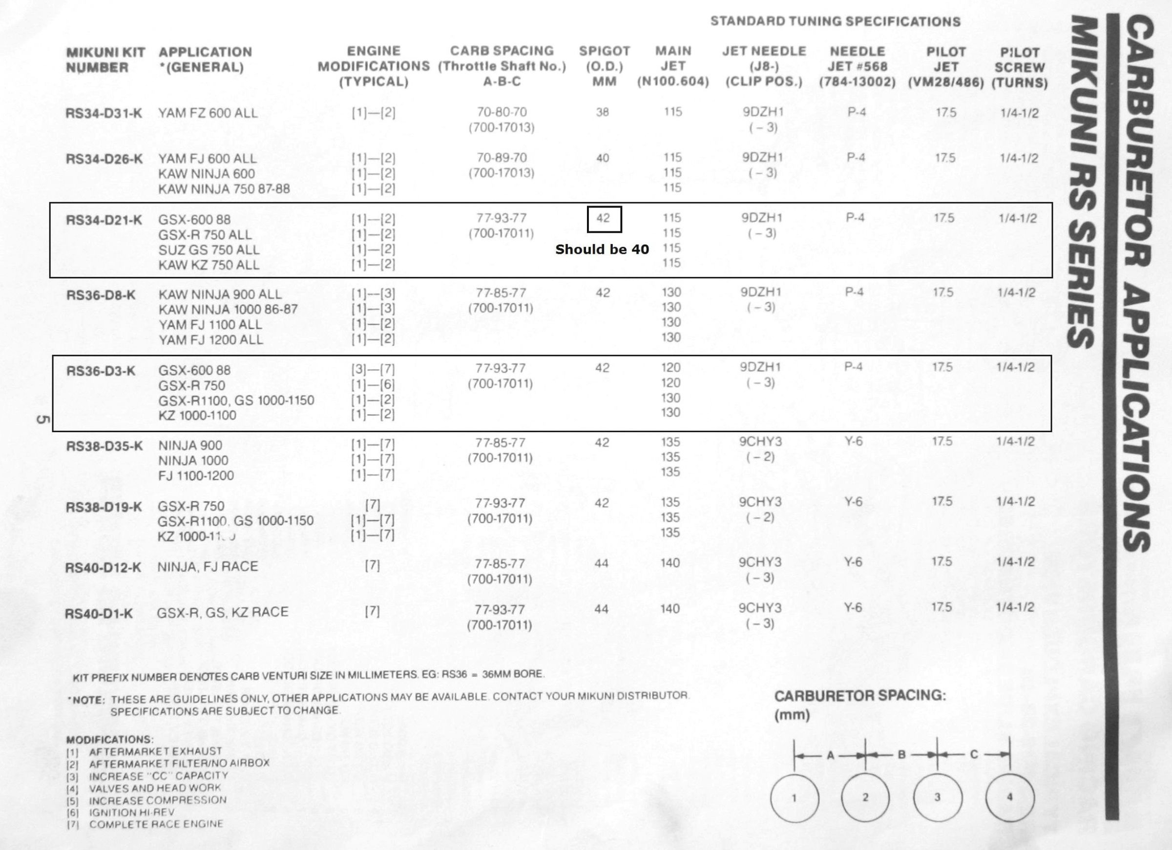

28 Nov 2016 20:09 - 29 Nov 2016 18:47swest wrote: See what's in them now. They might be set up right.
RS34's came with:
117.5 Pilot Fuel Jets
0.8 Pilot Air Jets
127 Main Jets
Needle raised one groove.
Changed to:
132.5 Main Jets
Lowered needle to 3rd. groove
I have yet to install them on the bike. Spent the evening checking them over good and cleaning them up.
Back to it in the morning.
_________________________
RS36's (on the bike):
0.7 Pilot Air Jets
135 Main Jets
1982 KZ1100-A2 Sleeper π

29 Nov 2016 07:01 - 29 Nov 2016 07:10JOE MKII wrote: Are the needle jet and needles the same also from the 34 to the 36's?
Nebr_Rex, I was taught that by a few old school drag guys I used to hang out with back in the late 80's, and it was reinforced by some testing in an old (cycle world??) motorcycle magazine doing air flow testing but only at wide open throttle, But I really don't know, like I said just repeating what I "leaned" .
Part throttle flow and atomization is what the good flat slides, smoothbores do better than anything, makes the signal so strong, really wakes up the motor, and the pilot circuit and the needle jet and/or starting needle taper become very critical in the jetting process.
Application chart from the Mikuni Owner's Manual below. Note emphasis:
Tuning information from same. Note Pilot Fuel Screw adjustment range:
