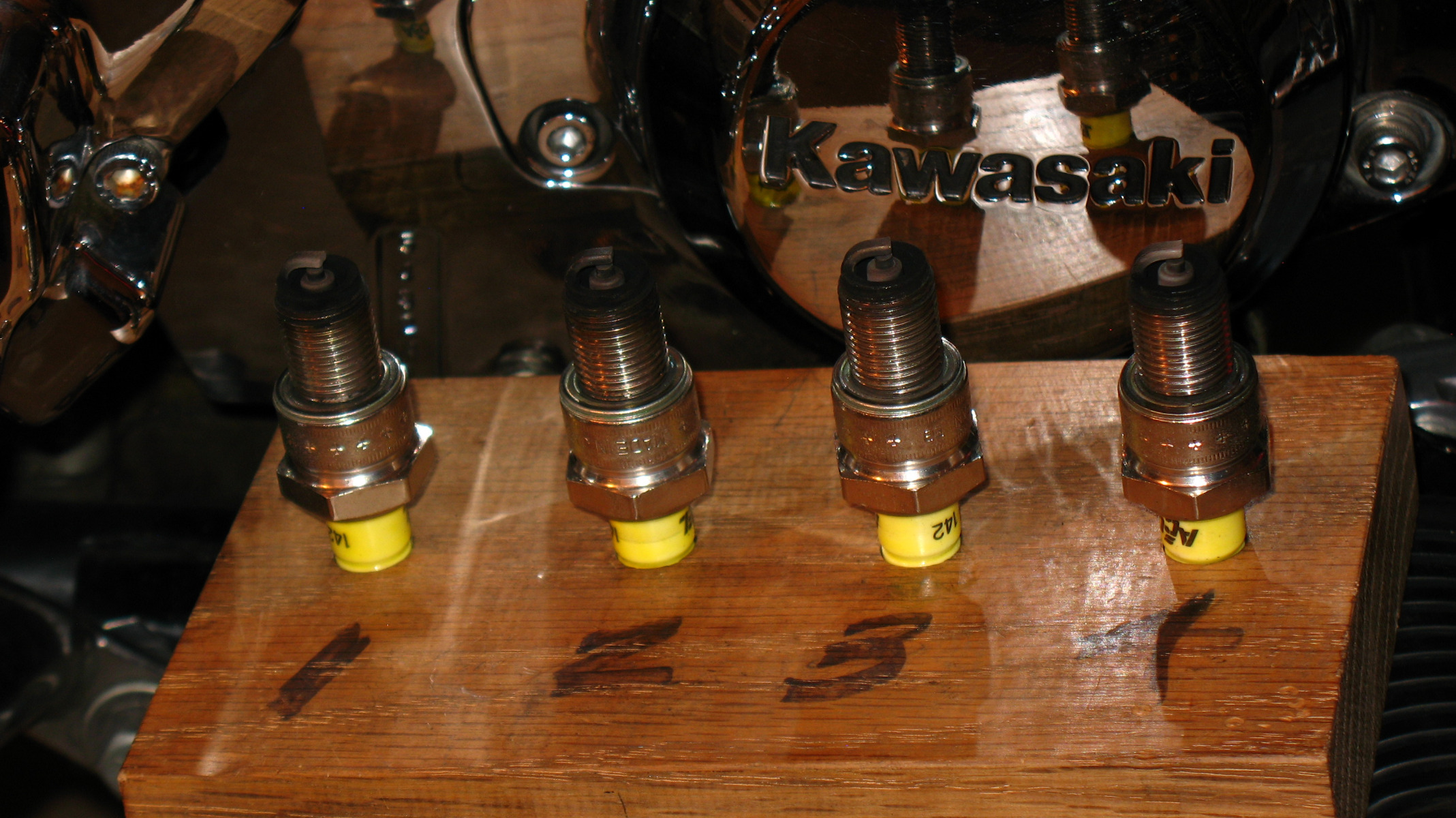

Been flying around with 115 main jets for a few days, and man oh man.
The plug color is starting to look pretty good. Acceleration is like I can't even remember, and no pops in any direction.
The lean changes probably won't reduce oil consumption much, but I gotta say I am blown a way how the old engine is running now. :evil:
