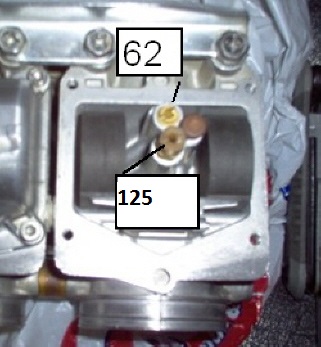

Patton posted this earlier and it might help
The Keihin logo should be on the carb but you wont find "CV34" anywhere.
If your carbs are like mine then the stock jetting should be Primary main 62 and secondary main 125. see photo

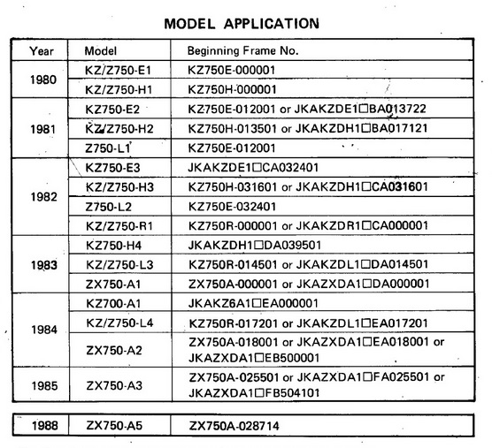

From the info I have been able to find and make some sense of here are the carbs on which model/year
1980 E1 and H1
Keihin cv34
1981 E2, H2 L1
Keihin CV34
1982 E3, L2, H3
Keihin CV34
1982 R1
Mikuni BS34
1983 L3
Keihin CV34
1983 H4
Mikuni BS34
1983 ZX 750 A1
Mikuni BS34
1984 Kz700 A1 kz750L4 ZX750 A2
mikuni BS34
1985-1988 ZX750 A3 - A5
Mikuni BS34
1980 E1 and H1
Keihin cv34
1981 E2, H2 L1
Keihin CV34
1982 E3, L2, H3
Keihin CV34
1982 R1
Mikuni BS34
1983 L3
Keihin CV34
1983 H4
Mikuni BS34
1983 ZX 750 A1
Mikuni BS34
mikuni BS34
Mikuni BS34

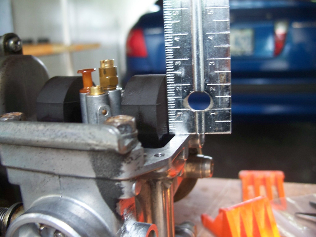

I used to use trial and error but then read a post here by Tek9ine an find the following method great
The picture below shows my carbs. The ruler shows a float height of 24mm. If my fuel level was 8mm and i needed it to be 4 then I would bend the tang until the float height was 20mm. This would raise the fuel level by 4mm to 4mm. below the bowl/body seam
I had to think about how best to explain and I hope it makes sense
Just realised I had typo above. Fuel level spec is 4 + or - 1 mm sorry
If your fuel level is 8mm below the bowl/ body seam then it is 4mm to low. So you need to adjust the floats to increase the fuel level by 4mm. You should target a final level of 4mm. You will need to remove the carbs from the bike. turn them upside down and remove the bowls. First check that the float are not upside down.
In the picture below, the red arrow points to the shiny metal part - which we call a tang - which presses on top of the float valve causing the fuel to shut off. This is the part which you bend to adjust the float height,

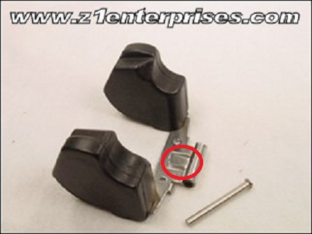

I "borrowed" the picture below from the Z1Enterprise site, It shows a float from a 750 twin and the tang is circled in red, Your floats will not be identical but the idea is the same. In normal circumstances with the carbs upside down on the bench like in the picture in my post above the tang rests on the pin at the end of the float valve and if you bend it one way you raise the float height and bend it the other way you lower the float height. If bending even a tiny bit does not change the float height then something is seriously out of place. Check the operation, check if the floats are upside down or catching the side of the carb

I took the picture of the floats at rest position:
From what I saw on the internet and manual floats ar not upside down. By the way when bending tang and measuring height should it compress the fuel level valve spring because of the weight or should I put carbs in that position which won't compress but just touches? I read different opinions on the net.
