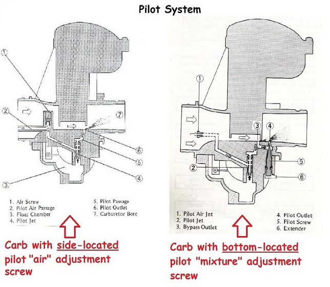

Am pretty sure the 1977 KZ1000-A1 stock VM26SS carbs have a bottom-located pilot mixture adjustment screw, and not a side-located pilot air adjustment screw.
Normal pilot screw position is 1¼ ± ⅛ turn out from lightly seated.
Turning the bottom-located pilot mixture adjustment screw out counter-clockwise (further away from its seat) enriches the mixture, and turning the screw in clockwise leans the mixture.
Whereas, turning a side-located pilot air adjustment screw out counter-clockwise (further away from its seat) leans the mixture, and turning the screw in clockwise enrichens the mixture.
The pilot circuit influences the fuel mixture up to 1/4 open throttle position, where size of the main jet doesn't influence the mixture.
Where adding choke improves performance at wide open throttle, the reason is something else besides the pilot jet or the pilot circuit.

02 Apr 2014 00:20
Thanks for the diagram I just checked my pilot mix screws they are all between 2 and 2 1/4 out Im betting that's the problem The carbs are absolute spotless so I bet whoever cleaned them just reset the screws wrong. Ill put the bike together in the morning and see how it runs at 1.5 1.75 T.O.
pscycle927
- Posts: 18567
- Thanks: 2103
Re: 1977 KZ1000a Jetting
02 Apr 2014 15:23 - 02 Apr 2014 15:23pscycle wrote: Thanks for the diagram I just checked my pilot mix screws they are all between 2 and 2 1/4 out Im betting that's the problem The carbs are absolute spotless so I bet whoever cleaned them just reset the screws wrong. Ill put the bike together in the morning and see how it runs at 1.5 1.75 T.O.
Might help, but only with side-located pilot air screws.
Will probably make matters worse with bottom-located pilot mixture screws.
