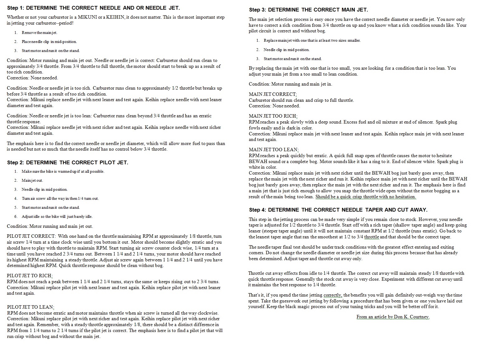

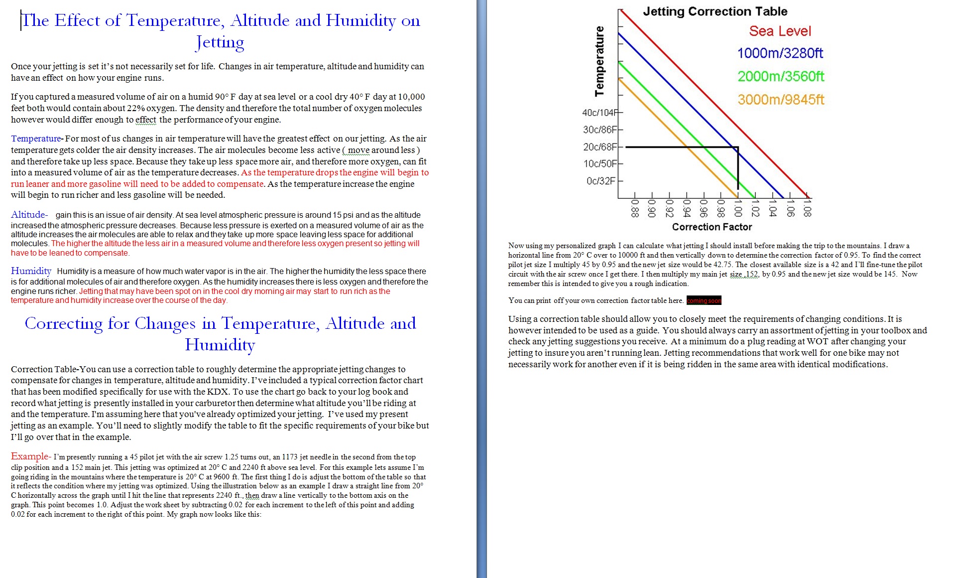

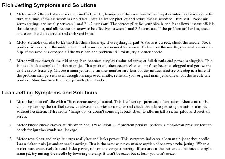

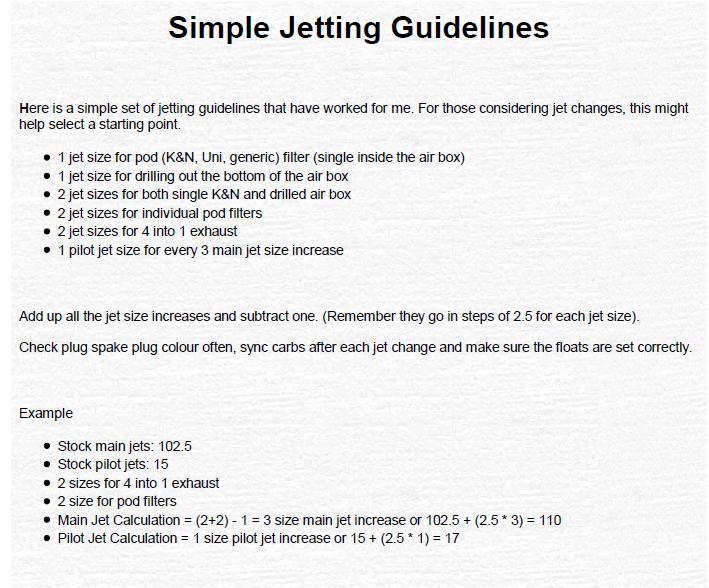

17 Apr 2013 03:32 - 17 Apr 2013 03:34The rule I have read is for pods, add one or two on the pilot jet and MAYBE go up one on the main. If you add low restriction pipes, add one or two on the mains. It all depends on how the overall airflow of the system is going.magruder13 wrote: Hey all, I was wondering if there was a guide or a rule of thumb for using pods and the corresponding jet size. I'm VERY new to carbs, I only barely understand how they work. I've been struggling to find a good place to read up on them, if anyone has a link I would love to read more. Also, where does everyone buy their carb repair kits / jet kits / parts from? Thanks!

The following user(s) said Thank You: ThatGPzGuy, bluezbike, magruder13, ejsimelaro

Old Man Rock, Where did this exert come from? It's too blurry to be able to read it all

17 Apr 2013 10:04 - 17 Apr 2013 10:05jonarmstrong wrote: Old Man Rock, Where did this exert come from? It's too blurry to be able to read it all
If your PC is similar to mine you can hold down the Ctrl key while you hit the + key and the image will enlarge each time you hit +. I tried this on OMR's posting and the test is pretty clear even when magnified. (Hit Ctrl - or Ctrl 0 to shrink it back to normal size). Ed
