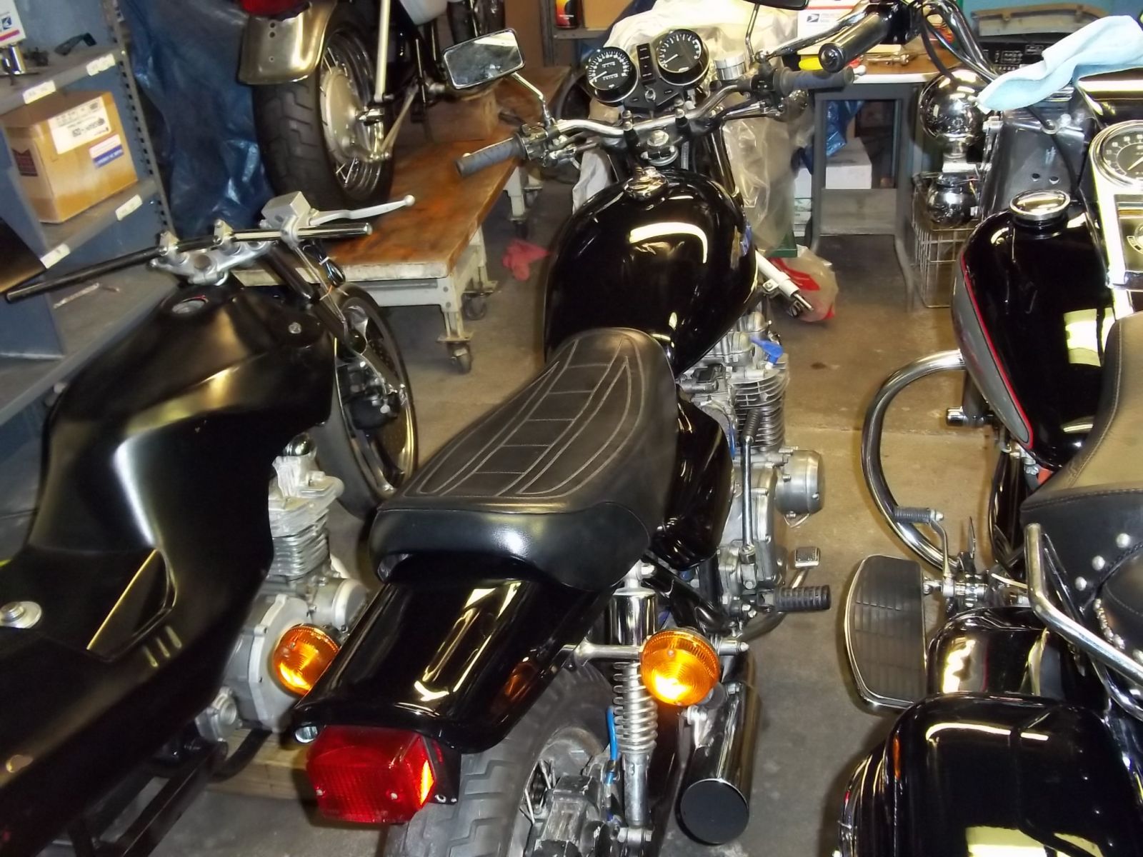

Nice info. My main jet tube is an "A" now. I took the adjusable one out when I took the straight pipes off after 20 years, After my restoration I have a sorry ass quiet stock muffler system. But that low speed needle adjusts just fine like that.
1975 was the last year HD used the bendix Zenith.
That Bendix works fine with my "Blue Streak" Ignition Points!

Man, that is one super clean bike! Ed
