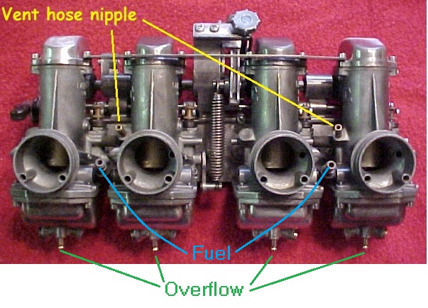

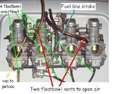

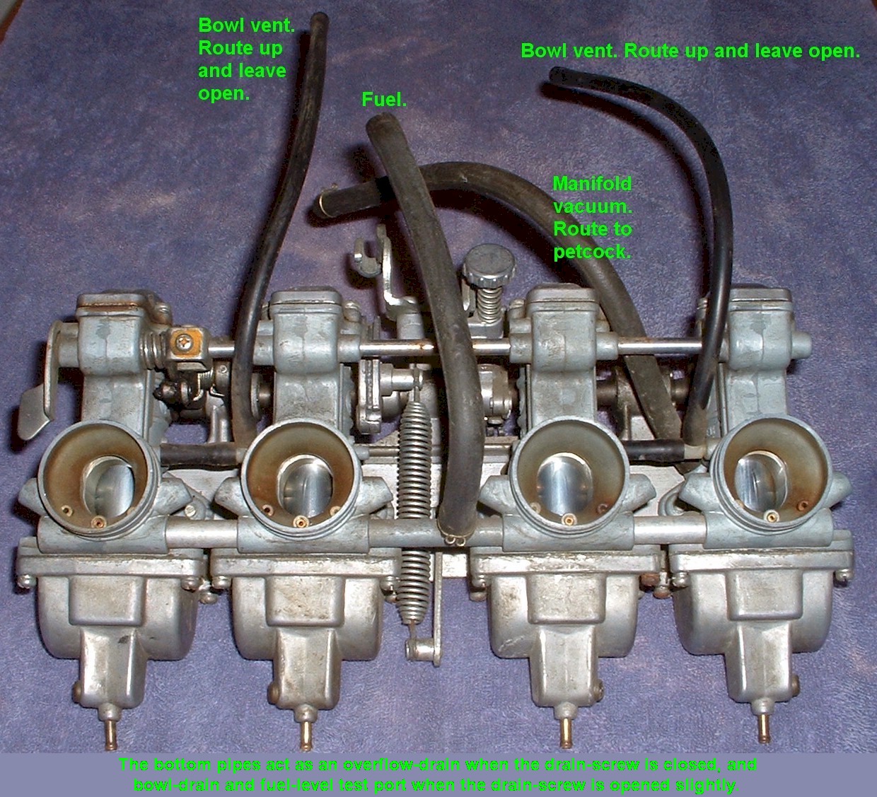

21 Sep 2012 20:44Important that each of the two vent hoses exits to open air, usually via a hose exiting underneath the bike, or into the air box, or underneath the seat.
The carbs shown have dual fuel intake tees for two separate fuel lines from the petcock.
The carbs at hand likely have only a single fuel inlet tee located in the center between the two inside carbs.
Would recommend that each fuel line should have an aftermarket in-line fuel filter.
Some carbs have a vacuum nipple -- that looks like a vent nipple -- intended for a hose to a vacuum petcock.
Be sure not to confuse the vac nipple with a vent nipple.
The vent nipples must exit to open air.
The vac nipple, if unused, must be capped/plugged, same as the vac nipples on the carb holders.
The following user(s) said Thank You: JKRowdy

These examples illustrate carbs with a vacuum nipple that looks similar to a vent nipple --
