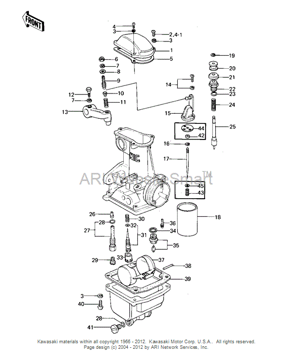

Yours look like this?
With the pilot screw #31 on the bottom? If so then it will be a fuel screw, so turning out will increase the amount of fuel to the Idle drilling. How many turns out will depend on several factors, but start the bike and warm it fully, take it for a ride. Then try setting them. Turn them in till the cylinder loses RPM, then back out to recover the loss, and and additional 1/8 turn. Try that and see how it runs on a ride, if it stumbles when you crack open the throttle, try another 1/8 open, and ride again. You'll get it.

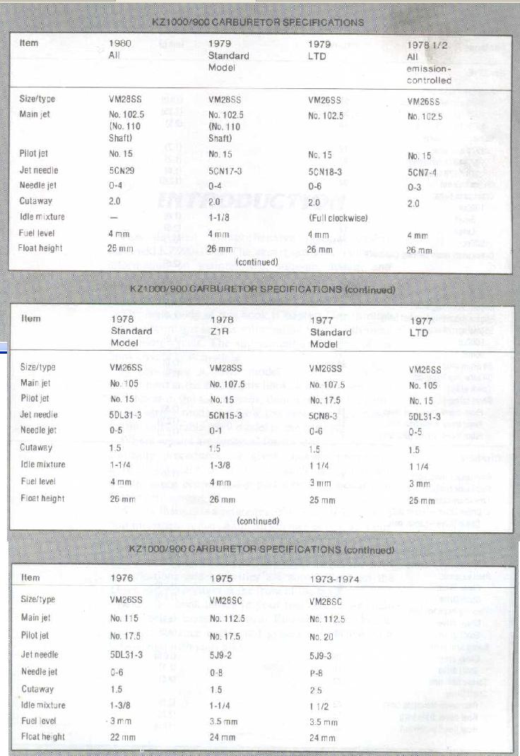

See bottom OEM settings...
Jets may be different due to change based on where you live....

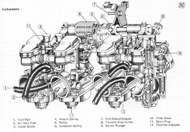

24 May 2012 11:25 - 24 May 2012 11:26Attachment KZ1000A2FSMcarbinfo.jpg not found
The one turn out is a default preliminary setting to be followed by fine tuning at idle rpm.
Final setting will likely be slightly different in each carb.
Don't be a slave to the 1/8 limit.
