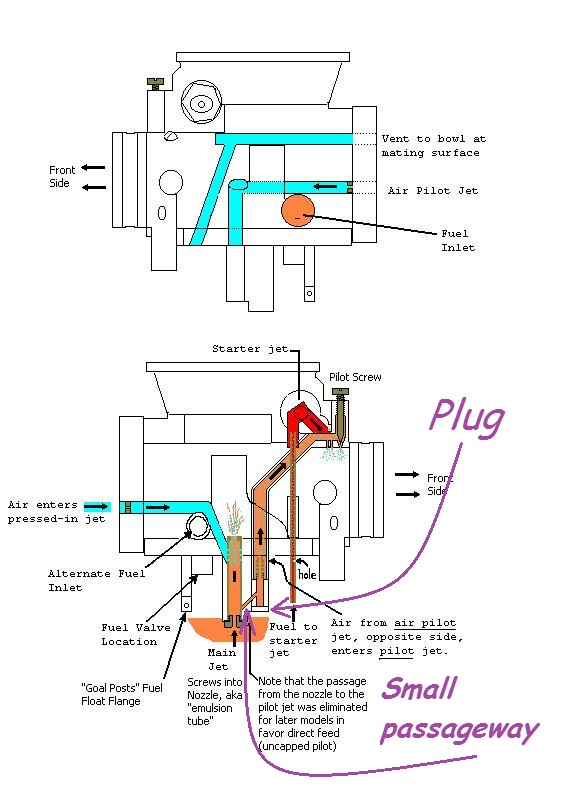

A larger pilot jet might help, but would first assure the existing jet and pilot circuit are perfectly clean , and that the pilot screw o'rings are in good condition.
If the pilot jet receives fuel through a tiny lateral passageway, would assure the passage is perfectly open and clean, and that the plugs are in position.

How would I go about cleaning those inside passages that fuel flows across? I soaked the carbs in carb cleaner and have blown air/carb cleaner through every hole I can find on them. Also, I think I have #35 pilot jets and cannot find anyone that sells these. Anybody have any or know of any? I bought the bike stock and made it a bobber. It wasn't running when I bought it with the stock airbox on it, but want the look of the the pods. Thanks guys!

Patton wrote: ... If the pilot jet receives fuel through a tiny lateral passageway, would assure the passage is perfectly open and clean, and that the plugs are in position....
AaronOregon wrote: ... How would I go about cleaning those inside passages that fuel flows across? I soaked the carbs in carb cleaner and have blown air/carb cleaner through every hole I can find on them....

When you say "Am thinking pilot jet plug" do you think they are leaking past the seal? When I pulled those plugs out to unscrew the pilot jets, I noticed the seals were pretty flattened out but they sealed pretty tight. Are they actual o-rings and are that squashed or are they made flatter like that?
Also, the "Fuel to starter jet" how do you clean this? Is this the one that looks like it has a little pin in it?
