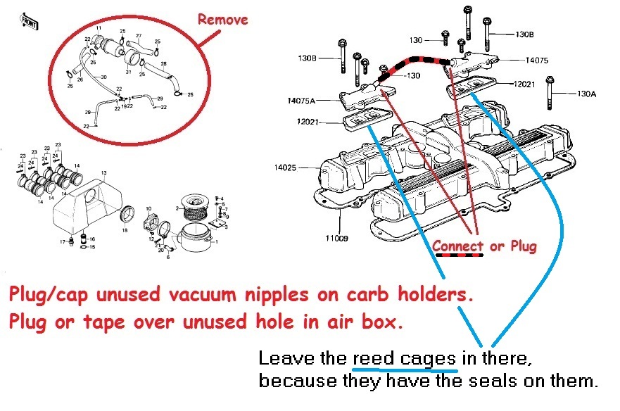

You should have TK-22. Sould be the same as my 1980 kz550 a1. Stock jets were 92/32 if my memory is right. I had a lot of decel popping so I removed the Smog System.
Just search decel popping and you see pictures for how to remove the smog system. You just have to make sure everything is air tight.

I went up to 95 for the main jets, but I have pods too. It should be about right for you though.
For the dog system just remove the tank, remove the smog system. The long hose can be measured and cut to fit across both front ports to connect them using the original spring clamps. Then you must plug or cap the small ports on the carb boots where the small vacuum lines were. Then tape or cover the hole in the air box. I would add pic but I can't figure out how on my ipad.
