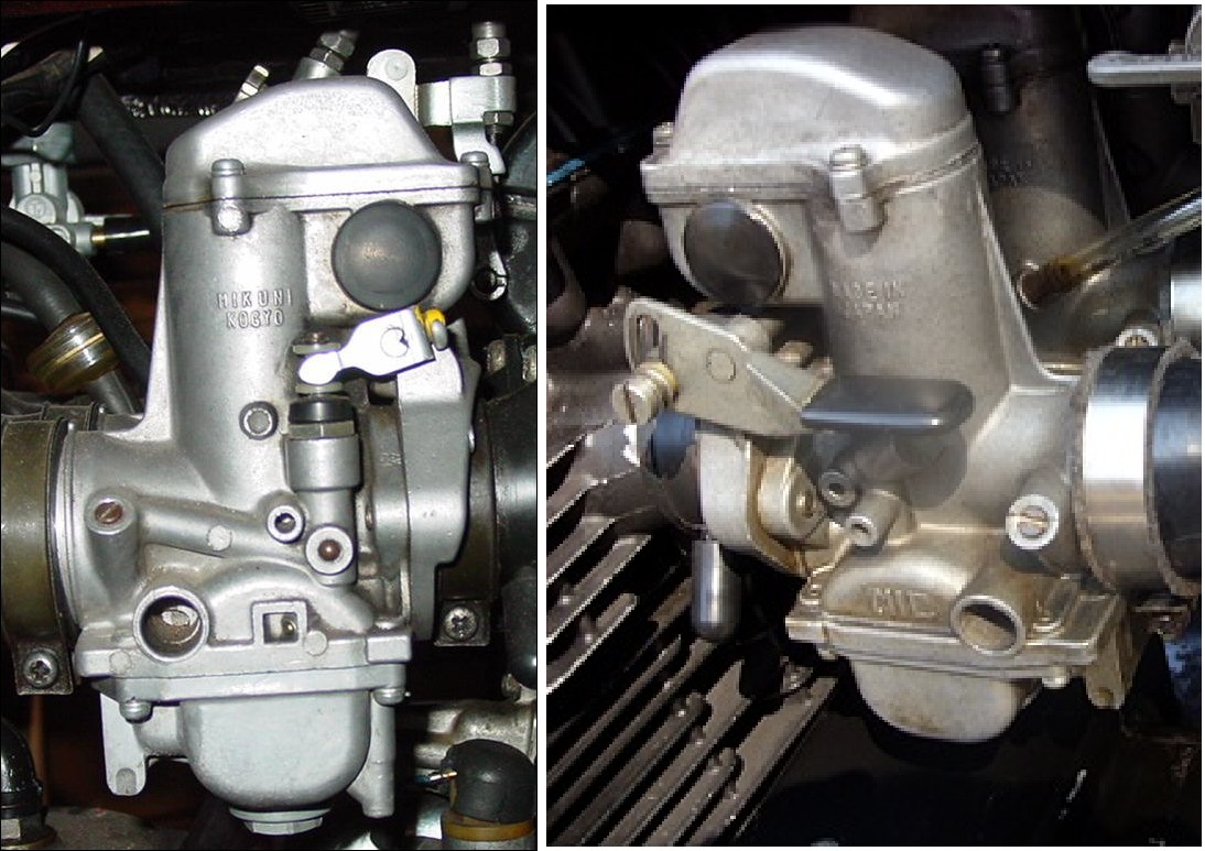

Can anyone tell me what carbs I have? 1980 kz1000 B4, I've seen pics of 28's and 29's and have not seen my carbs,no accel pump,17mm drain plug,I'm thinking that I'm still running lean and want to change the pilots,currently running 17.5's

Those look like 29s to me.
Here are some pics for comparison
Attachment 29jet.jpg not found
Intake side
Attachment 29mm-Smoothbore-carbs-side_2012-02-21.jpg not found
Right side while on bike
As for the pilots I cant say ?

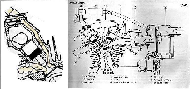

Powerstroke_fan wrote: stupid question, but could it be the emmission ports causing to pop on decel?? only reason i suggest it is mine did the same till i plugged them.
Seem to recall others having reported unplugged ports caused popping exhaust.

22 Feb 2012 19:06
#505696
Not a stupid question at all,after your post I gotta thinkin,the previous owner had connected both hoses with a T and to a small pod filter,I wouldn't have thought about it, BUT I pulled the filter and put a 3/8 bolt and clamp!Whatta ya know no more DECEL POP.I'm gonna pull the tank tomorrow and replace the hose with just one piece.Thanks a bunch this has been drivin me crazy!And Thanks Patton for the emission pics.

Attachment KZ1980Emissions001.JPG not found
Hey Guys I've seen everything now, I thought that I had been over every inch of this bike,come to find out I guess I haven't, check out this contraption that the previous owner did!2 pieces of 5/8 hose to a 3/8 tee with 3/8 fuel line going into the 5/8 hoses and a small filter pod. I replaced the hose with 1 piece of 5/8 heater hose and ALL the decel pop has went away.If any of you guys are @ the Vintage Japanese show in Jefferson PA in August I'll buy ya lunch!Thanks again
