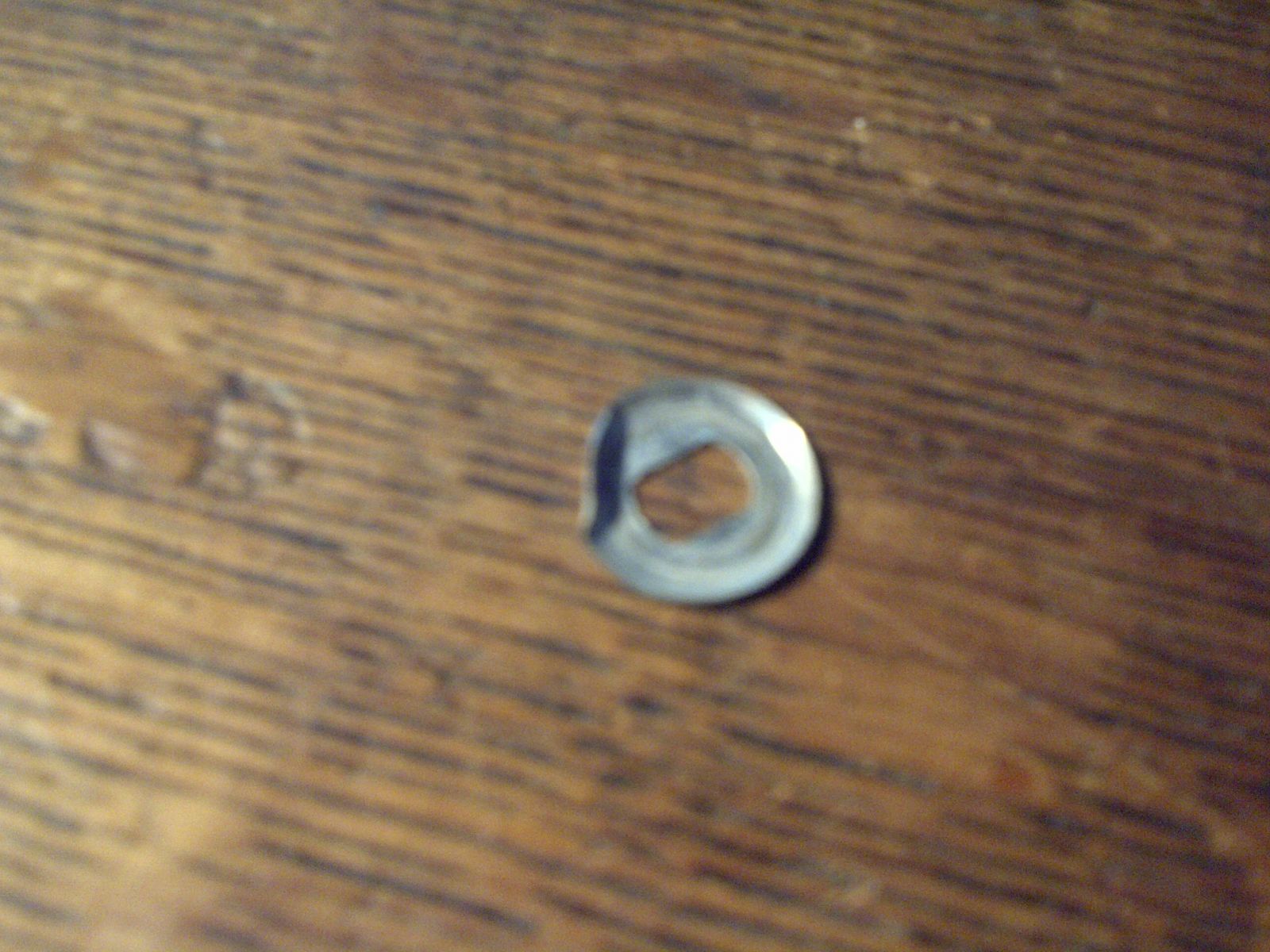

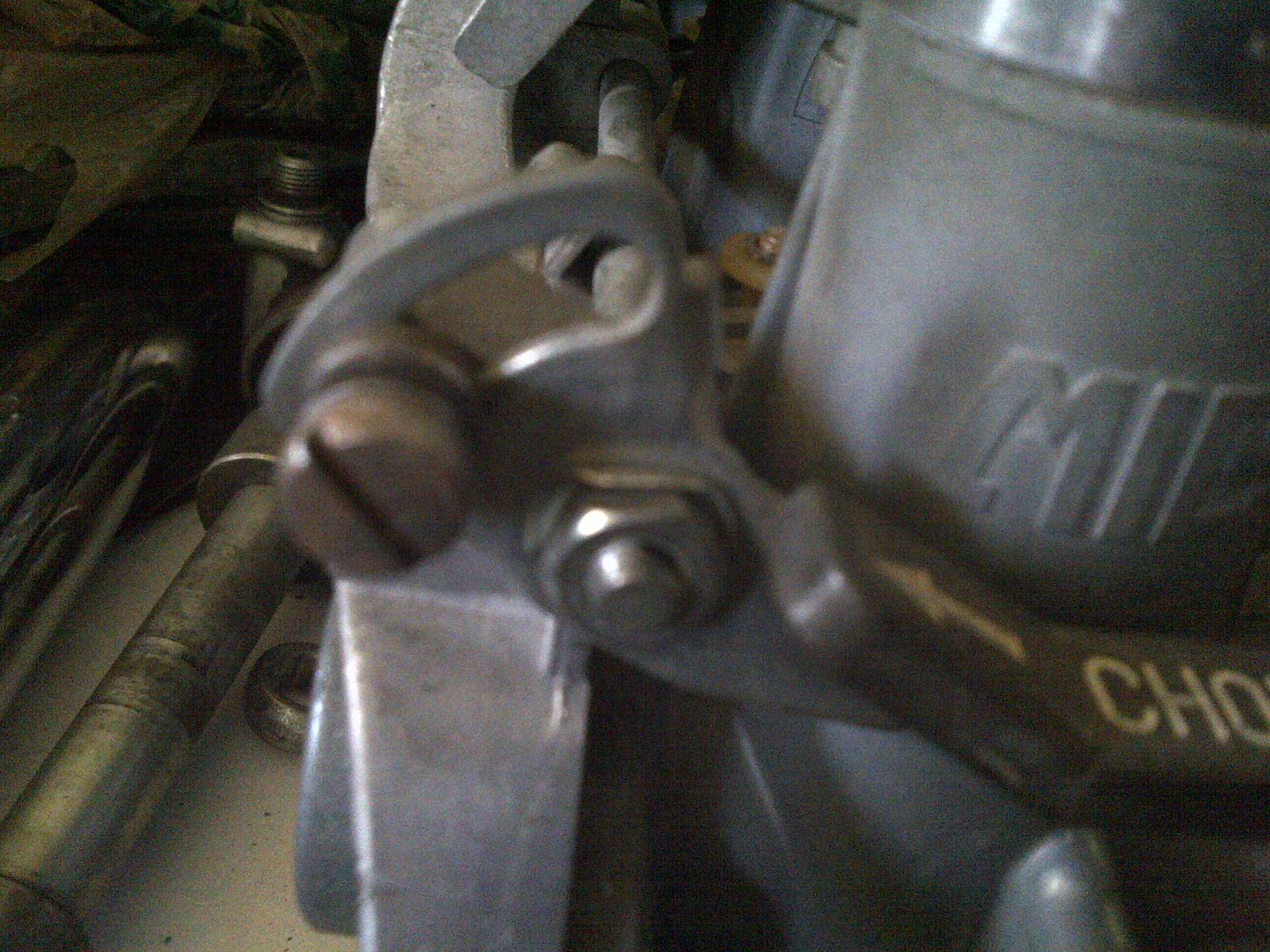

the 1975 has the choke lever bolted the the end of the shaft instead of welded.
there is a special locking washer that go between the nut and the shaft lever.
Any idea what the part # for it is?

Cant find a part number for it. But I do know its only a washer with the end bent too lock the nut in place. So shouldnt be hard to make one. And you wont see it anyhow.

03 Jan 2012 13:48peter1958 wrote: Cant find a part number for it. But I do know its only a washer with the end bent too lock the nut in place. So shouldnt be hard to make one. And you wont see it anyhow.
Thanks Peter, I can't find a partbook/microfiche that show the separate lever either.
The washer has to be a little more complicated since the en of the shaft is not round but rather rectangular with threads only on the narrow sides to take a 6mm nut.
still would like to find the part #

Thanks Peter. With you pictures I was able to find the part # (16054-007)
it is listed for 74/77 KZ 400
