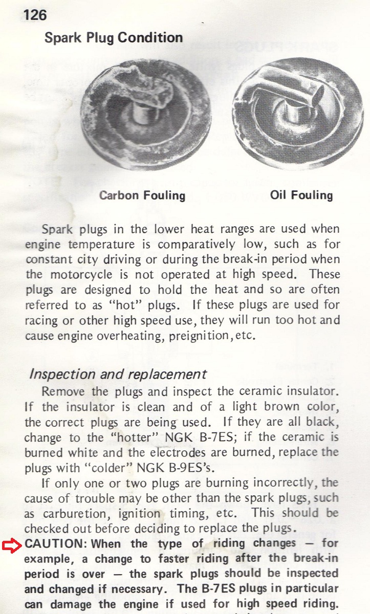

24 Oct 2011 14:39mtbspeedfreak wrote: ... how can I observe a fat blue spark? Do I pull the plug and ground it on the cylinder head? Second: pilot screws, are these also known as the air screws? I adjusted these last night, the air screw on the cylinder (#4 if it matters) that was running perfectly was turned out significantly more than the first three cylinders, which were black, black black!....
Yes, I prefer removing all four plugs (may rubber band or tape the plug pair together) before holding them against the engine head while spinning over the engine.
Yes, air screw allows more air into the pilot circuit when turned out counter-clockwise.
running NGK B6ES's -- this is a No-No for KZ900 where "7" spark plug is the hottest permissible plug.
The service manual says 7s and 8s are OK. The manual doesn't mention 6s, obviously. The manual also doesn't mention 4-into-1 exhaust, pods and rejetting the carbs.
Is a single heat range really a problem? (other than what I said earlier about hotter plugs being a workaround for another problem) I was told I could run 5s during the right circumstances. I mean, I've put twenty thousand miles on 6s without any problems- the only time it overheated was cruising down the Vegas Strip, stop and go and stop and go for 60 minutes in 95 degree weather at 10 PM on the Sunday before Labor Day last year. Once I got back on 15 and air was flowing around the jugs, she was fine. I run top shelf Amsoil 10W-40.
Per FSM:
Enhanced engine performance may sometimes benefit from a colder running "9" spark plug (NGKB9ES) in racing or extended high speed applications.
I would concur with the assessment of "hotter plugs being a workaround for another problem," but also thinking that standard NGKB8ES plugs may prevent onset of more serious problems.
