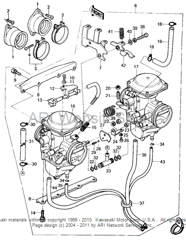

Are parts 2, 3 and 4 present and accounted for?
Perhaps the spring has weakened?
Maybe it's the wrong spring?

12 Oct 2011 00:25Patton wrote: Are parts 2, 3 and 4 present and accounted for?
+1 remove and check spring, may be rusted to worthlessness.

OK then #15 is the spring for the throttle adjustment, with the cable adjustment mechanism, #13, having the threaded end and the threads in the left carb body being in question. Are the threads all right, will it adjust but not hold? Maybe this spring is shot, #15.
