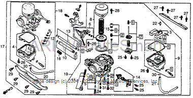

it looks to be these carbs, there is no diaphragms it is a metal top...odd to me having just re-built kz1100 carbs with rubber diaphragms. also the floats are plastic and non adjustable...odd little carbs if you ask me. i am working on the exhaust now, gonna try jb weld first... then if i have to take them off and bring them somewhere. i havent checked the timing... i have to find the service manual for this bike i dont even know where to look for the timing!

What are those in the breakdown then, the cap on top, and the spring, then? Looks like it would have a diaphragm.

10 Oct 2011 08:07Motor Head wrote: What are those in the breakdown then, the cap on top, and the spring, then? Looks like it would have a diaphragm.
Manuals can be had, they are on the net for free download if you search. I just got a Concours full service manual, off of a Russian server, free pdf file.
Those carbs look just like the Kiehin carbs on my CB750F. That thing in the diagram that looks like it should be the slide with the attached diaphragm from a Mikuni CV (#8 points to the cap and piston) is actually a metal piston that fits closely inside the cap. There is a diaphragm but it's small and goes into the side of the carb body. In that diagram it's marked as #14 for the assembly. It's a small diaphragm about the size of a quarter with a spring on top, and then the cap covering that.

BTW I should add that when I tore into my Kiehin carbs from the F'er those small diaphragms were hard as a rock. It had been sitting since the mid 90's. Also the accelerator pump diaphragm was similarly hard, and I wouldn't expect it to work either. The accelerator pump is marked as assembly #7 in your diagram.

So those are Vacuum Pistons, Sans Diaphragms. I can't tell from the drawing what the #14 is, but mounted up on the side seems that it would be a Coasting Enricher.
The Flat Spot described should rule out the Accel Pump, as it is for up to about 1/4- 1/3 throttle. I saw the CDI in the parts section. Those vacuum pistons may well be effected by the low back pressure on the one side. Making it lean.
