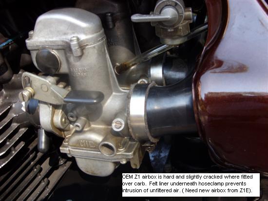

Is there anything wrong with using some stainless hose clamps to hold the airbox-to-carb boots in place? The stock clamps weren't in good shape and the hose clamp seems like the perfect replacement.
