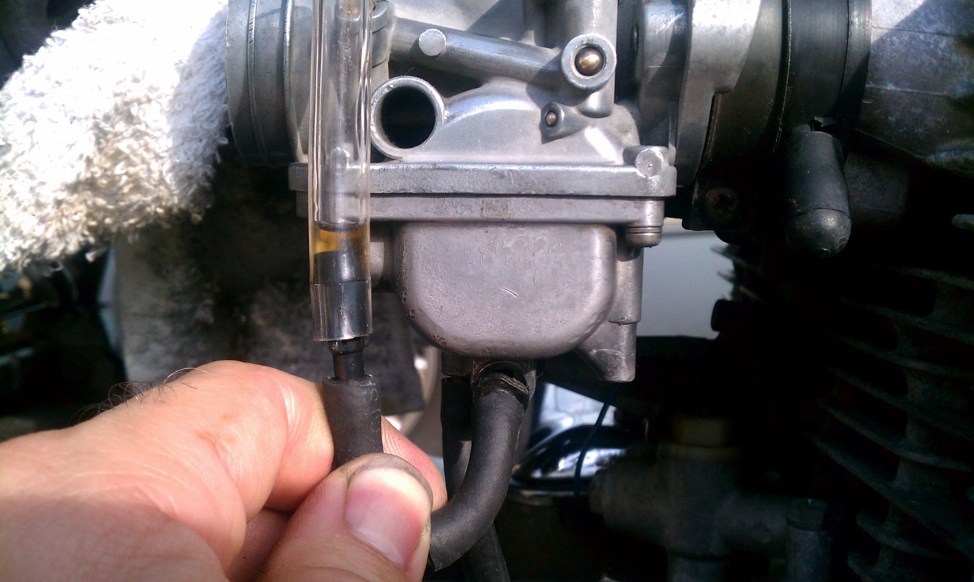

I would buy the cheap $10 filter at first. I believe the K&N non-pod filter is a high flow filter which may effect the volume of air and therefore your set up anyhow. Maybe someone else here can confirm that. But you should definitely do your adjustments with the filter on. But first, if you haven't already adjusted the floats, adjust them using the clear tube method.
You would need to take them off the bike and mount them level somehow (workmate bench, etc) and put four of these tubes on each of the float bowl drain holes (I used a drip irrigation pipe coupler from homedepot and clear tubing. Self threaded the one side of the coupler into the drain tube hole the other side slipped into the clear tube). Test and readjust as necessary. Check out this thread by P21, he does a class job on this: Clear tube method . Also, check your overflow tubes in each bowl. Yours could be clogged. This will eliminate any issues with fuel overflowing into your air box. Should bench sync as well while you have them off. Once you have them back on the bike the set your mixture screws at 1 1/2 with filter and try again.
