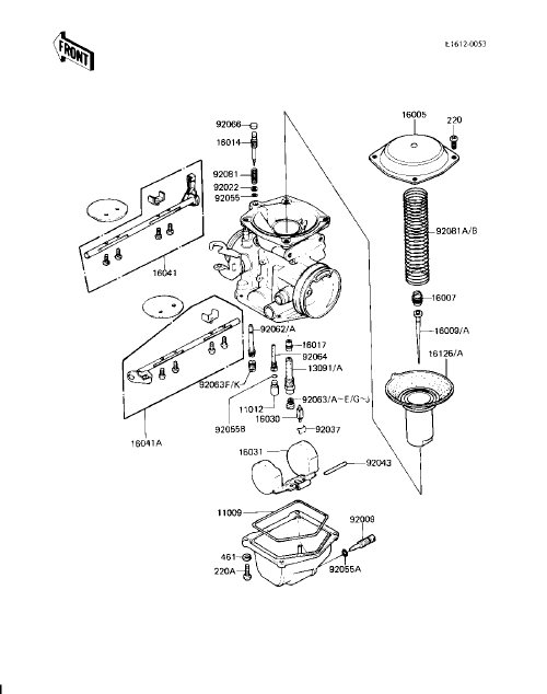

Completely dissasemble your carbs and clean everything. If you couldnt find the pilots, its cause you didnt look under the little nylon plugs...
If you blow with your mouth on each of the slide ports, you should feel the same resistance across all four carbs and they should slide all the way up and then return to idle when you stop blowing.
Use the supplied diagram for dissasembly, and blow carb cleaner through the carb ports in the bottom while looking to make sure that cleaner blows through all the small holes into the carb bore. Visually verifying that fuel will flow unobstructed.
Install everything airtight.
Good luck - mix scres 2.5 - 2.75 turns out with pods.
