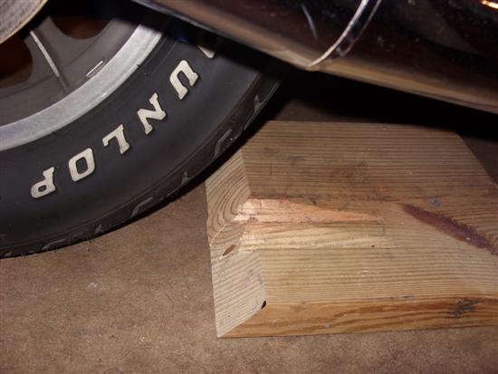

The LTD may be easily lifted onto a center stand (borrowed from a standard model) by first rolling the rear wheel onto a piece of wood. Such as I have used for years.

Patton's tip about using the board to get the bike on the centerstand is spot on and works great.
