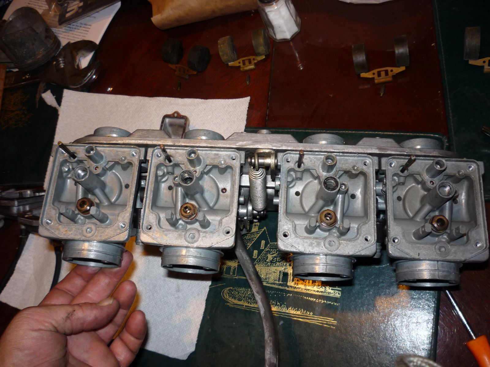

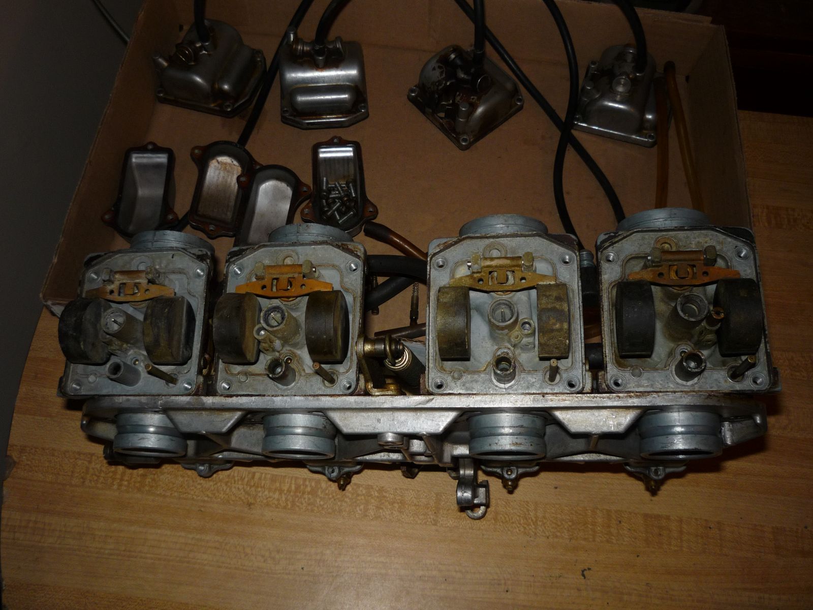

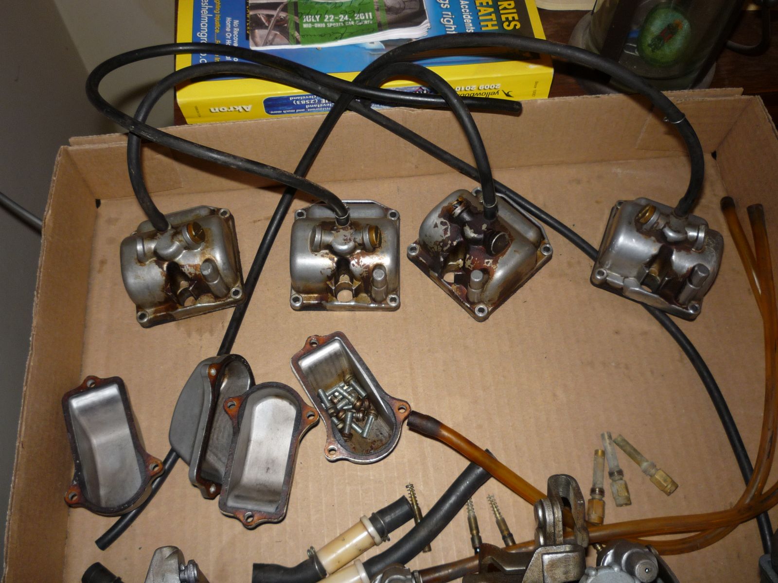

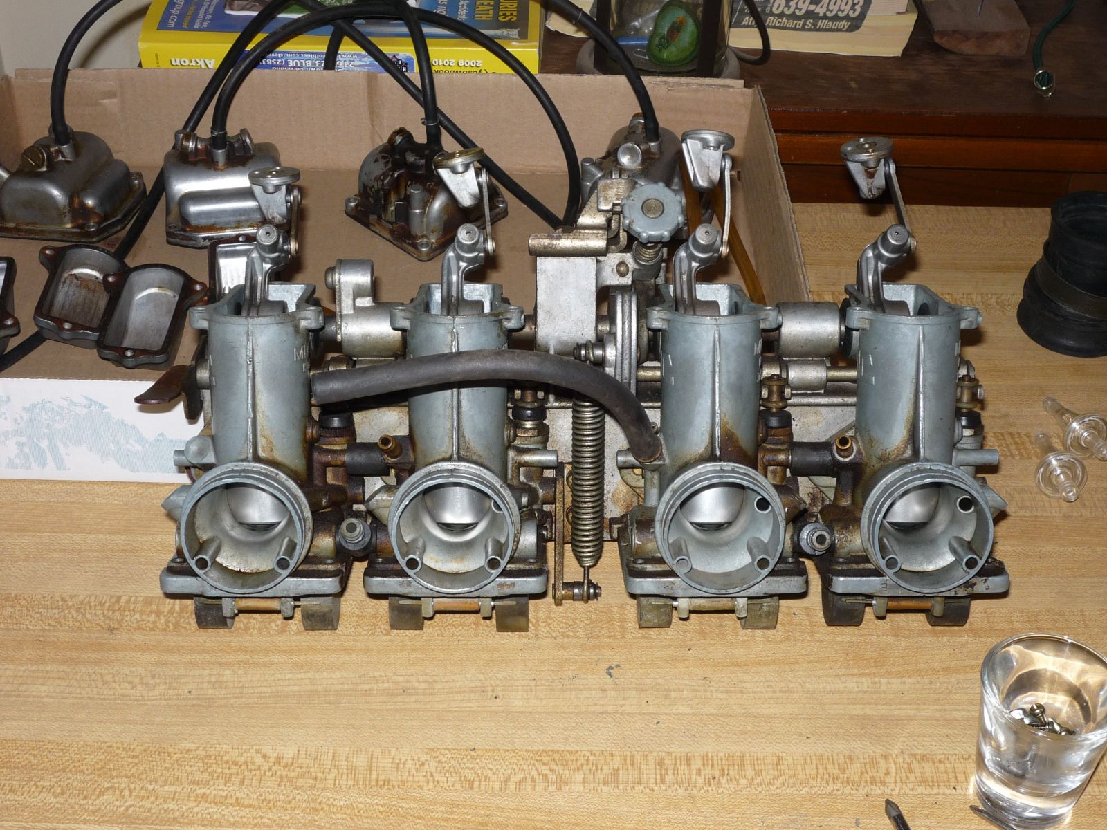

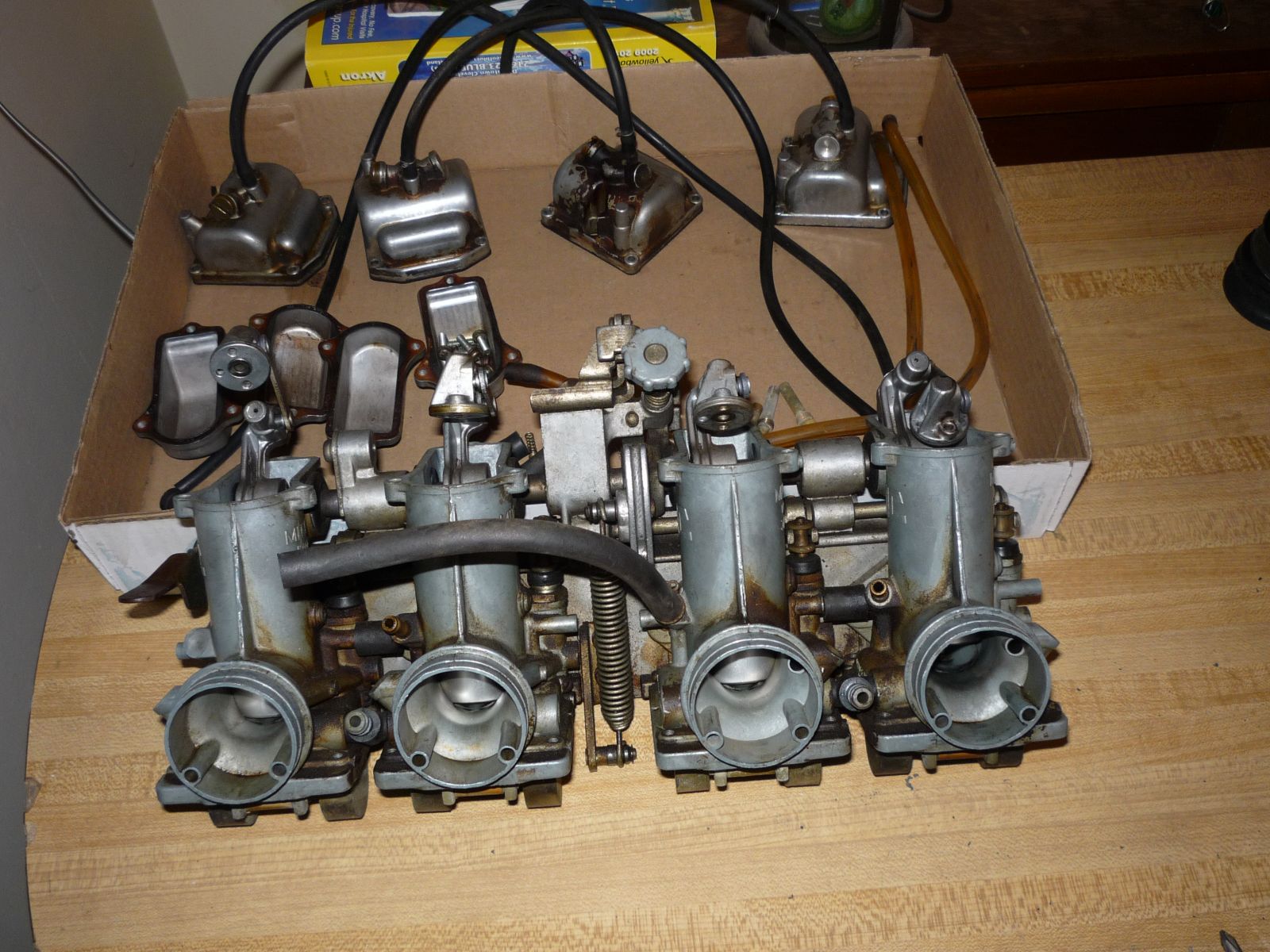

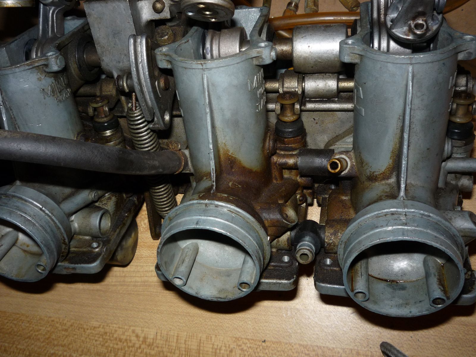

16 Aug 2011 01:21 - 16 Aug 2011 01:30Since I'm getting lazy in my old age I decided to have the carbs off the 78 KZ1000 I just bought ultrasonically cleaned at a local dealer today. I have to say I'm pleased with the results. It only took about 1/2 an hour and cost me $36.00. Compared to the old way of spraying tons of carb cleaner and scrubbing this is the way to go. Here are the before pics.

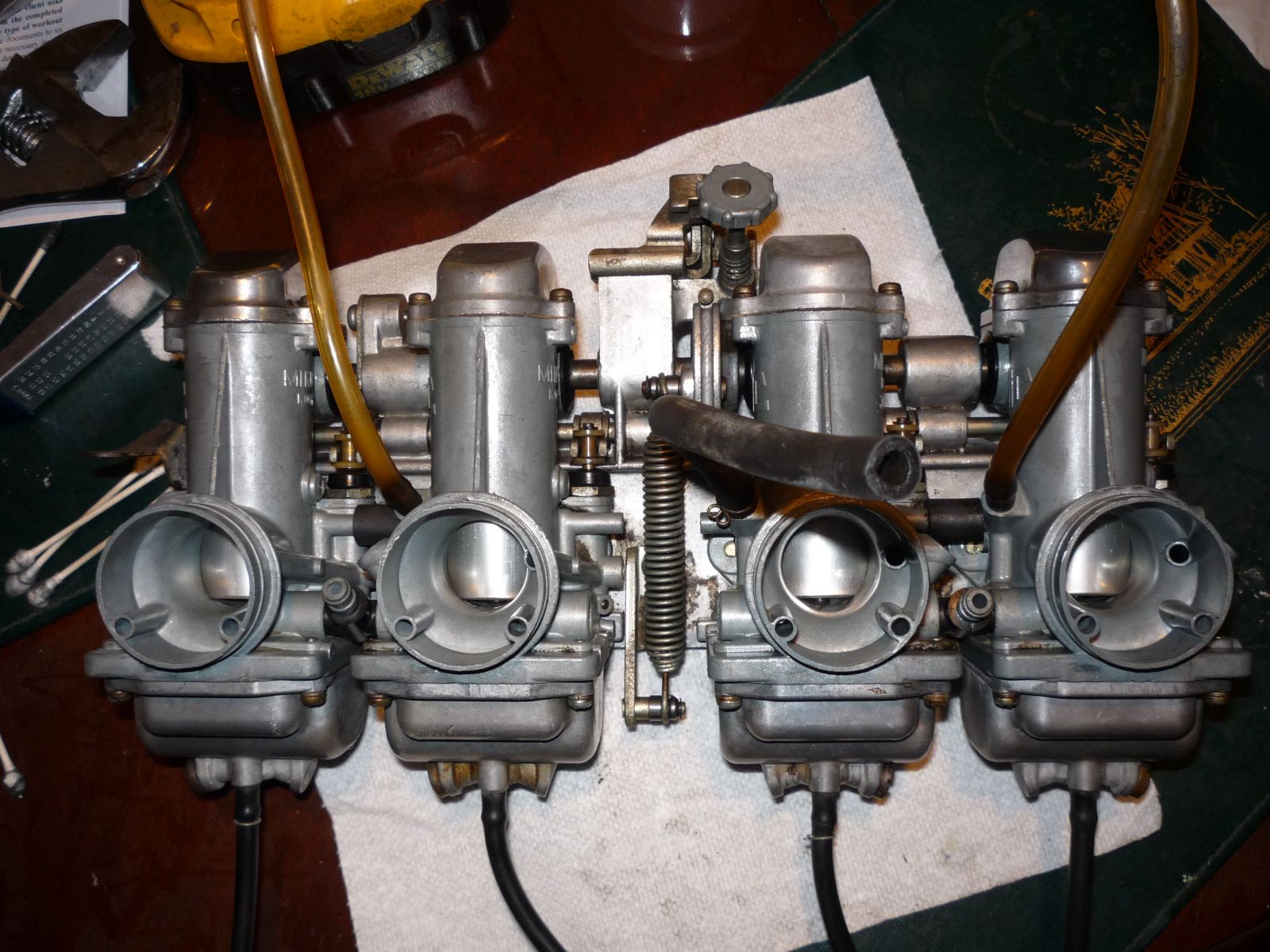

The after pics wouldn't load on this post see next post.

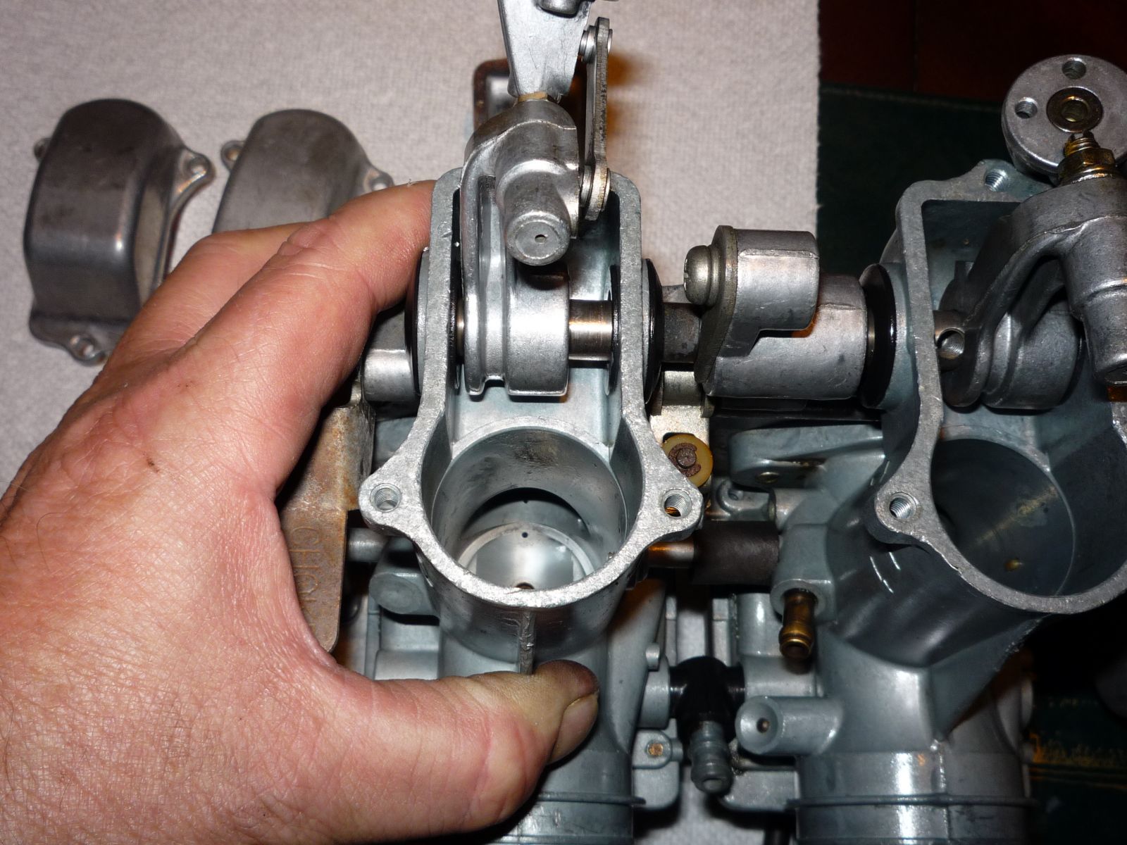

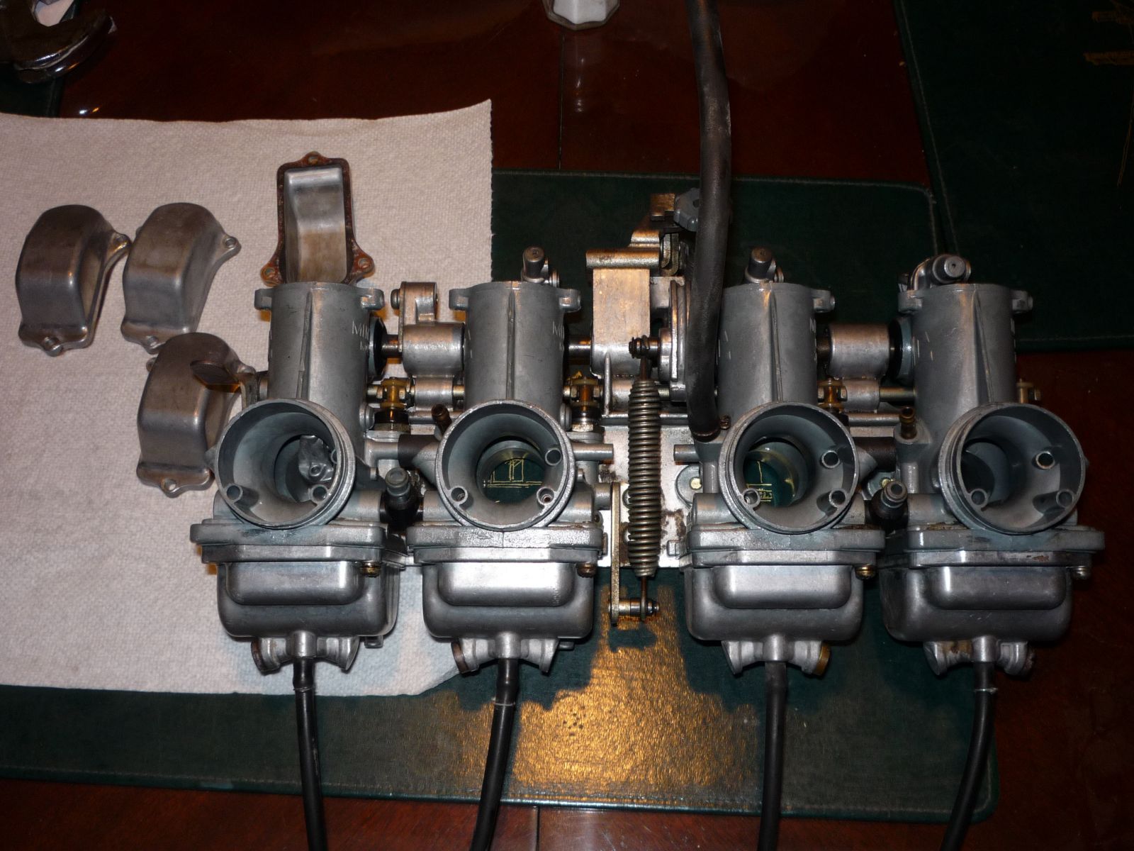

Here are the after pics they work like butter and I put in new pilot jets I bought from Z-1 Ent. I'm planning on installing them in the morning and hoping this beast will run like it should.

Michael, yes they had one large enough to hold the entire rack of carbs. I removed all the jets, slides etc. but left the rack together.
