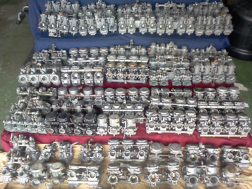

I wanted/needed one, and asked around and a friend suggested getting one big enough for a cylinder head - V-8 cylinder head. Mine holds 7 gallons. They're touchy to the level of liquid - the heaters burn out quickly if the level isn't right - mine luckily had a lifetime warranty on the heater, and they fixed it and hand wrote a note with a sharpie that says - 'Check water level.'
I made a filter system for it using a common car oil filter Fram $3 each when on sale, remote oil filter locating system $14, some hose, and an inline 120v water pump $90. Hint: do the same thing on your parts washer, but you probably won't need the pump.
I always disassemble everything as much as possible - in most cases it is being rebuilt as it goes back together anyways.
10 year old gas:
15 minutes later:
[/url]
25 year old gas (I know - I get all the good bikes :lol: )
15 minutes later:
Some really nasty carbs still have frozen slides/throttle valves, but the Ultrasonic makes for a cleaner starting point, and with a little soda blasting love, and other techniques they can be beautiful.
For other wash solutions, I have a collection of beakers and jars that I can put parts in - then sit in the basket - ultrasonics do their thing just as well, so if I want to use simple green, bourbon, or whatever, it makes for easy work.
They show up used from medical and dental places: just know what was through it before, and have a plan for disposing of the muck that you're going to generate.

Holy Sh1t thats a lot of carbs. Im going to have to pick up an ultrasonic cleaner. Those things are amazing.
