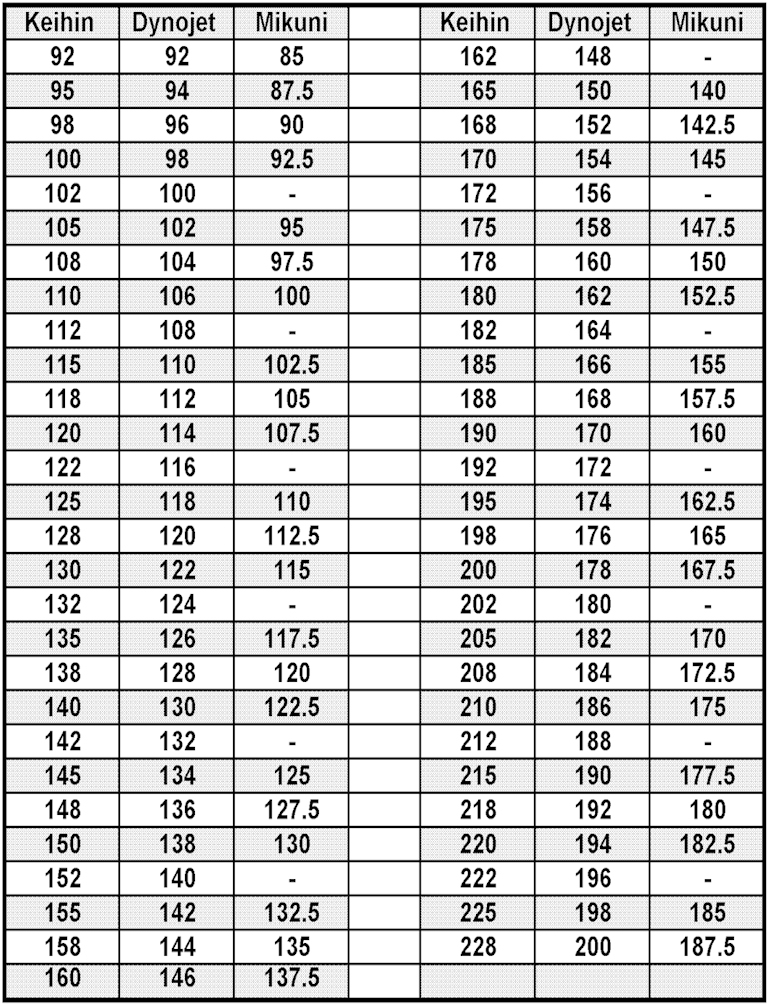

That 165 main jet might be a dynojet main which is completely different fuel amount than a mikuni main. Check to see the taper and needle number to check if a dyno jet kit was installed with those pod filters - most likely.
If it was a 165 kehin jet swapped in, then it would be around the right size.
Mikuni jet numbers flow different rates of fuel than Kehin and Dynojet Jets of the same number!
The stock carbs for that bike are Mikuni BS34 CV.
The stock jets would be a #40 Pilot, stock needle in middle clip position, and #122.5 Main, but this would be too lean for pods BY FAR! Try a 140 Main to be safe, and set the mixture screws around 3 turns out to start.

not jets from a dyno kit. jet diameter is 0.0640 and stamped 165 which is matching for the Keihin jets. Bike is running way to rich so going leaner will be my first direction. Owner just bought the bike (not running).
what you have (135's) is exactly where I was going to start.
