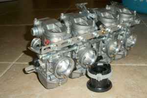

Found a good deal on a set of Keihin cr 33 special, but seller said it is for a ninja 750 ( he is not sure though). Do you know if it would fit a kz900? Or how to check for the specific bike application ?

as long as the spacing between the carbs is right (i believe that these are adjustable for cylinder spacing)then you just have to make sure that you get the right size intake boots and you should be good to go.
you will most likely have to do the setup as far as jetting adjustment etc.
