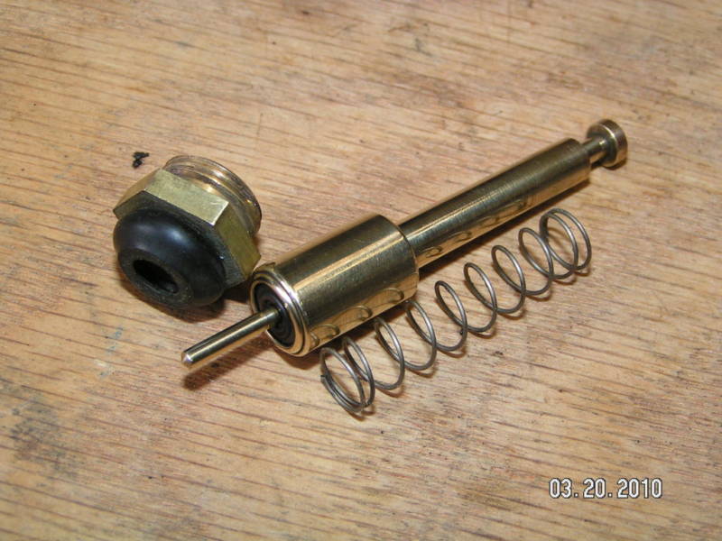

Make sure to dissasemble the carbs completely before using any cleaners in there.
The choke plungers are the parts that move in and out of the carb bodies as you adjust the choke.
With the carbs off the bike. look at them and move the choke. You will see it moving all the little choke plungers up/down as it should - or maybe something is broken...
They can be easily screwed out of the carbs for inspection/cleaning.
the most important thing to when cleaning the carbs is to spray cleaner through the pilot hole in the bottom of the carb, and watch for it to squirt out all the tiny little holes in the carb bore.
This will assure you that the pilot circuits are clear and you wont have to dissasemble them again later not being sure that they are clean.
Good luck.
Choke pic:
Good luck.
Choke pic:

I had the carbs off earlier today and the plungers are moving in and out of the carb bodies at the same time. I did not know that you could screw them out. I'll take the carbs back off tomorrow. What do they look like when you take them out ?

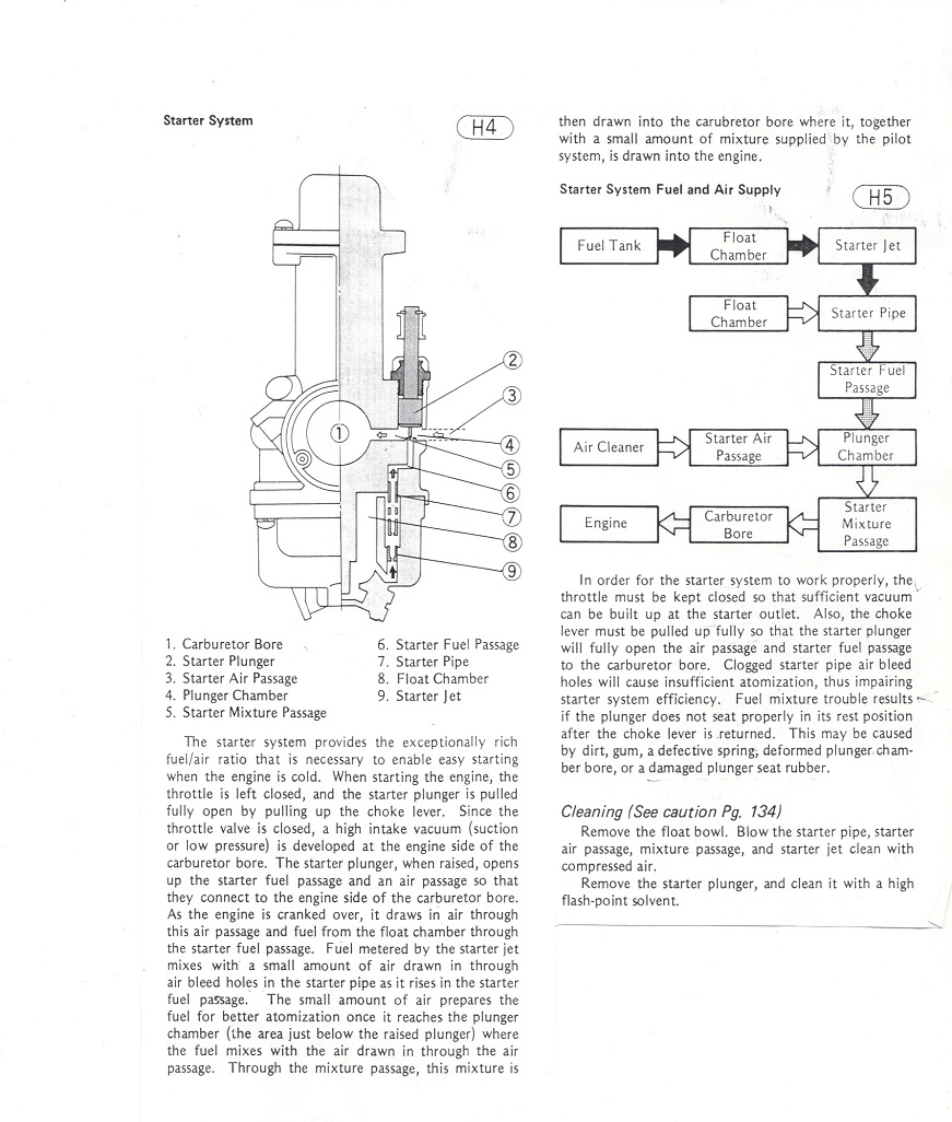

Is the starter pipe the thin copper pipe that goes into the bowl ?
