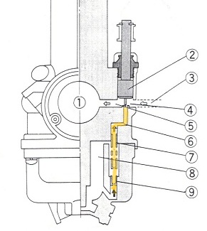

Yes, I believe you are correct. The long one that protrudes at the edge of the carb bottom.

BIGKEVIN wrote: Is the starter pipe the thin copper pipe that goes into the bowl ?
Might also describe the overflow pipe that attaches at bottom of float bowl.

I took the carbs apart yesterday. Took the choke plungers out of all 4 carbs and was able to shoot carb cleaner into the hole where the plungers came out of and got carb cleaner out of all 4 starter pipes and into the carb bore. Put the carbs back together and back on the bike, still no choke. Is there something that I am missing ?

BIGKEVIN wrote: I took the carbs apart yesterday. Took the choke plungers out of all 4 carbs and was able to shoot carb cleaner into the hole where the plungers came out of and got carb cleaner out of all 4 starter pipes and into the carb bore. Put the carbs back together and back on the bike, still no choke. Is there something that I am missing ?
Am presupposing that carb cleaner was also sprayed into entrances of starter passages to assure spray exits into the carb bores.
Throttle slides must be in fully closed position (i.e., all the way down) to maximize the enrichment function.
In other words, don't touch the throttle grip during attempt to start a cold engine while choke lever is pulled up in ON position.
still no choke --- Are spark plugs still completely dry after attempting to crank cold engine with choke ON and not having touched the throttle grip? :unsure:

I did not spray carb cleaner into the starter passages. I just took the plungers out and sprayed into it and the carb cleaner came out of the starter pipe and also went into the carb bore. I did just try starting the bike with the choke on and no throttle. After trying for a few minutes, I took the #1 and #4 plugs out and they were not wet. They did smell like gas but were not wet.
