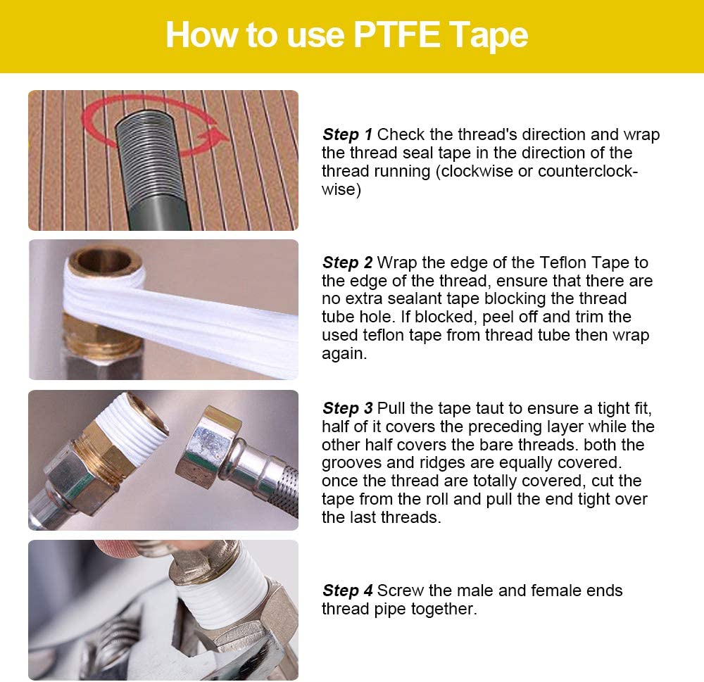

I use some wraps of PTFE Teflon tape on the bleeder threads to get an airtight sealing during the normal and vaccum bleeding process.
Otherwise air could be permanently suck in through the bleeder threads when you release the brake pedal. Ask your plumber next to you for the tape.
