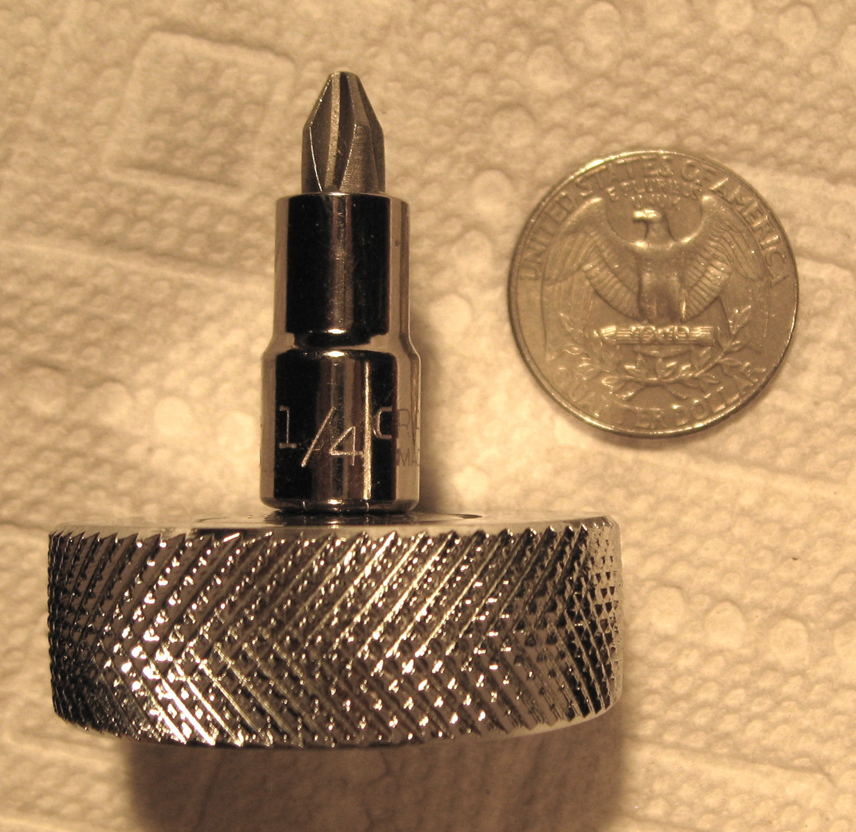

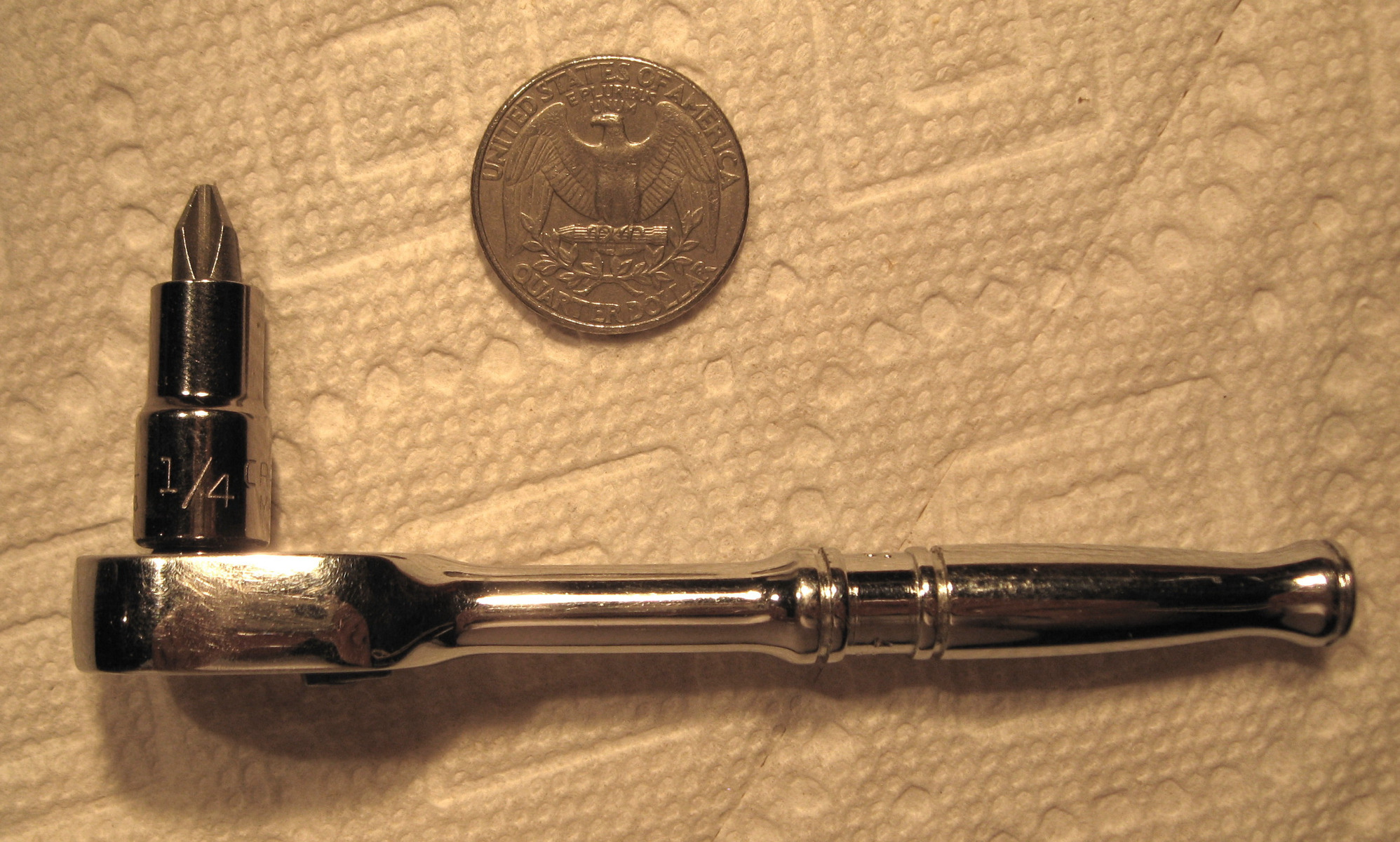

I need a JIS screw driver to get to the carb holders. Two came in my tool bag and the larger one (~1/4 in diameter) fits the screw but I'm not sure if it is a P2 or P3. Does anyone know?
I need to purchase a shorter (stubby version?) since I have less than 6 inches between the air box and the carb holder.
Also, if you know of a good screw driver that is short I'm all ears.

I believe those are #3 size.
Re: JIS Screwdriver P2 or P3?
25 Jan 2019 06:14Nessism wrote: I believe those are #3 size.
I agree. Best bet is to try the #3 and make sure it fits properly. Ed

I've been using Q-tips to apply Liquid Wrench all around the fasteners for a few days now. The top fasteners are blind but the bottom ones are exposed, so I've been hitting the back of the bottom fasteners with Liquid Wrench as well. I just bought a set of 1/4-inch JIS bits (#1 thru #3) as well as a ratchet set with a 3/8-inch drive to 1/4-inch bit adapter that should come mid- next week. The plan is too keep on applying Liquid Wrench every day until the bits /ratchet arrive, then take out the carbs and attempt to remove the fasteners. I also got some Loctite Blue 242 and plan to apply them to the bolts when I install the new holders.
Will let you know how it goes!
