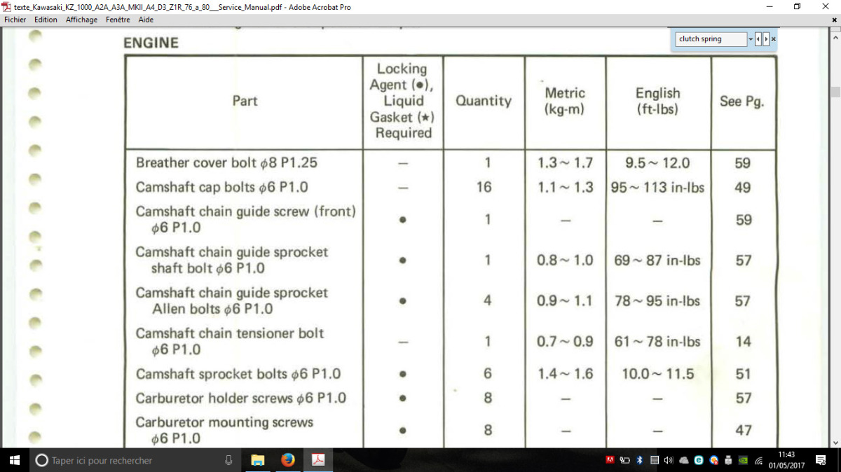

Hello,
Just buy a new decent torque wrench and will start to work with it this afternoon...
But In the manual i have spec in kg-m and in-lbs
My torque wrench is in : NM or LB-IN
Example:
Clutch spring bolts at 0.9 - 1.1 KG-M or 78 - 95 IN-LBS
- Is in-lbs same has lb-in ?
- What do you use for unit to work generally?
Thank you
Example:
Thank you

And i don't understand why they put ft-lbs on the top of the table and all units are in-lbs inside the table

Is it an error on the table title?

Re: Torque wrench
01 May 2017 06:58 - 01 May 2017 07:31
No, it's for simplicity. Kawasaki service manuals assume the user has already obtained a certain level of training & competence.
When a Kaw mechanic sees in-lbs, he'll know to grab the small torque wrench.
(or he may do it by feel using a regular wrench without over-tightening the bolt).
