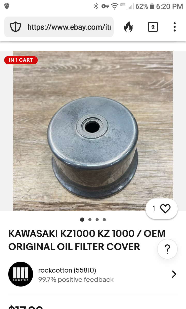

First oil change in my 78 KZ1000. Found no cover on the top end of the oil filter. Found a diagram on the forum with part #13169. Couldn’t find it on Partszilla. Any help would be appreciated. Thanks,Kevin

That's not an oil filter cover, it's a crankcase breather housing...

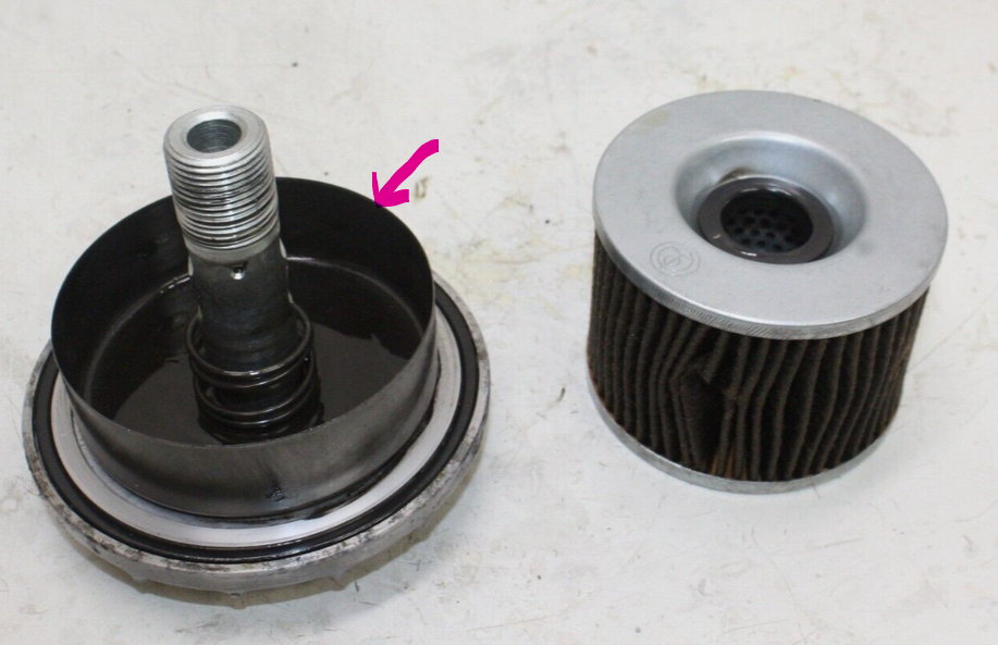

I think the Z/KZ 1015cc engines did not have one. The later J 998cc engines did.

afaik. the fence protects the filter element from oil pump pressure. the 650/750 oil pump orifice is near the bottom end of the element and the 900/1000 orifice is probably near the top. the early 900/1000 oil filter had a metal/perforated cage around the element. as shown in Rolf's pic. so a fence isn't needed. if new oil filter doesn't have the cage. run it without the fence. then next oil change inspect the element to see if there's any pressure damage in one spot. probably won't be. edit. but lacking the cage. consider installing a fence.
