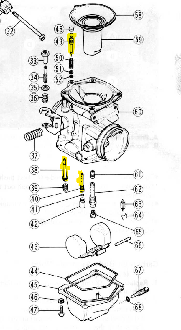

When cleaning the carbs, did you ungang them? Soak in carb dip after removing all hard parts? Replace all the various O-rings.
The bleed pipes and pilot jets must be removed and held up to a light, to make sure the tiny hole is open. And the pilot circuit must be clean.

Other idle issue such as pilot jets has been mentioned, there are diagrams on here about spraying carb cleaner in those orifices to make sure internal circuits are functioning.
These orifices are often not blown out with compressed air after cleaning which could cause running issues at idle. Just because you stick carbs in a ultra sonic tank does not mean you cleaned them (not saying you did that)
