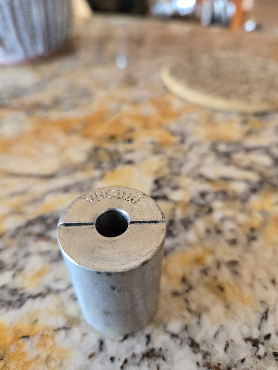

Do yourself a favor, if the machine shop does not know about these engines and getting the valves correct buy one of these from APE and let them use it . It's a gage to get the valve in the correct range of shims about the middle. It has a step and by placing it it the cavity without spring seats you can tell right away. if its anywhere between the lower step and top you should be within range.
Where are you located. If you'r on the West Coast Schuman Motorworks will do a good job and he will set the height to where you want them. Otherwise he will get you in the 300 range.
