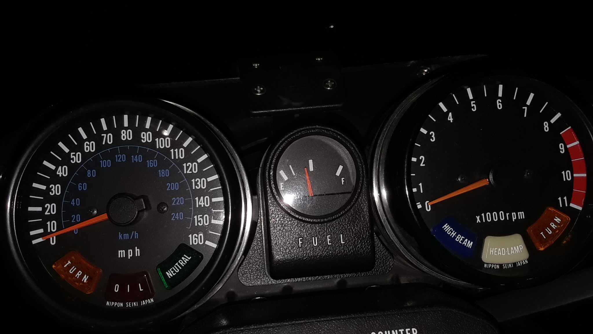

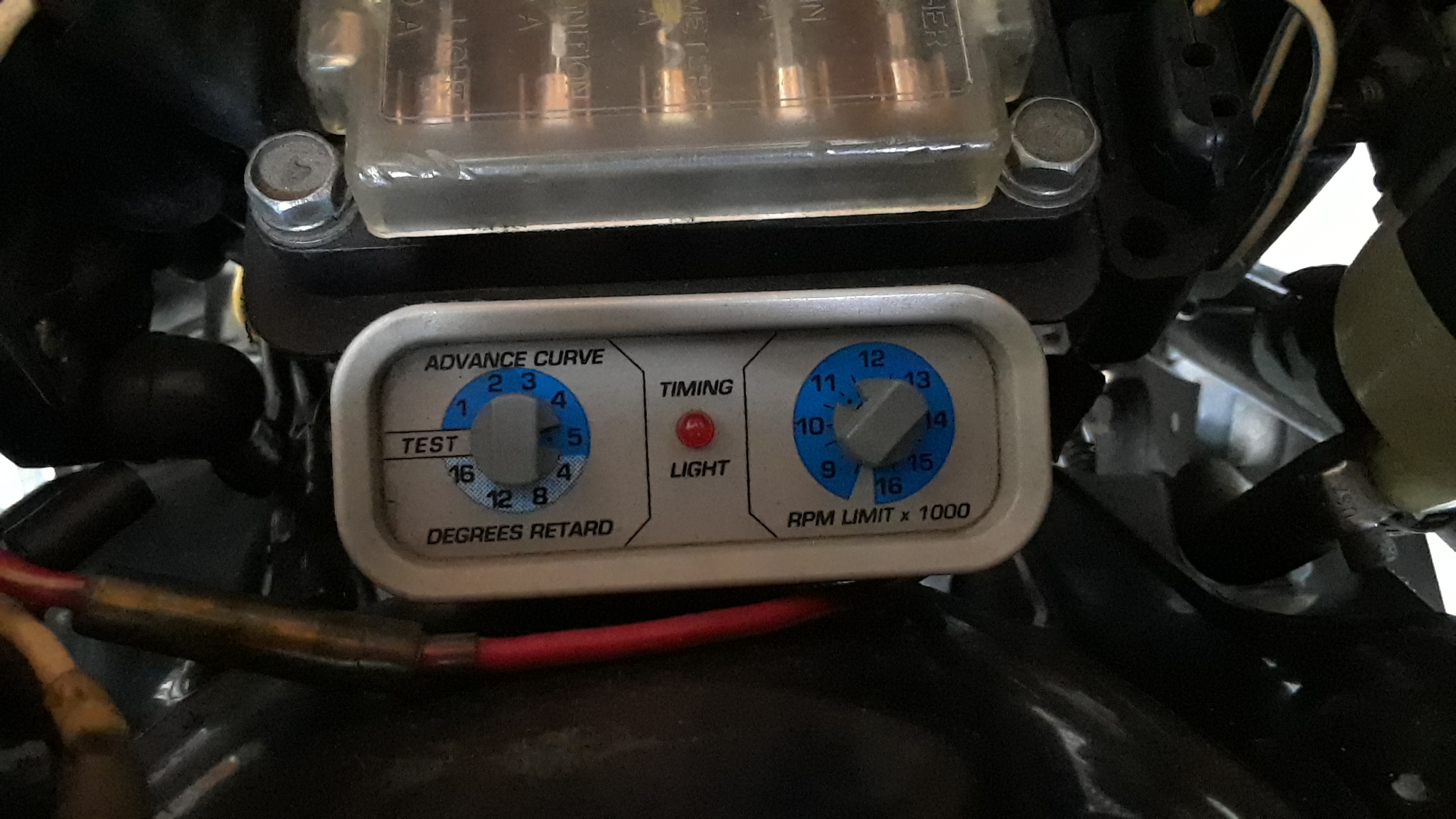

Me motor wants to explore the 8.5K-11K RED zone on my tachometer.
Feels like she can handle it, but I don't necessarily think it would be a good thing to do regularly.
Not sure what to set me rev limiter at either...

You also don't want to exceed 38 degrees of total advance on these engines especially on a street ridden bike (I saw the picture of that Dyna box) 36 degrees is safer and you won't feel much of a difference.
You can go to 40 degrees but that is mainly for drag race engines which run for short duration (printed on the Dyna rotor)
Set RPM limiter at 9500 for a street motor, shift at 9000 (higher OK for a drag engine)
