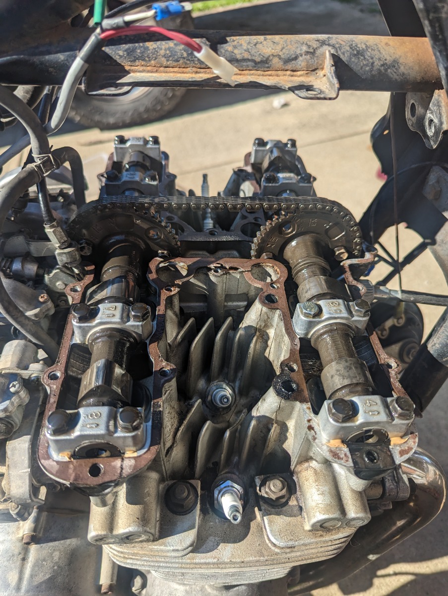

Okay so I popped the valve cover, and immediately noticed that I'll have to replace the gasket. It came apart in pieces. But I took the measurements, with some difficulties because I was having some trouble understand the FSM procedure. It said to take the measurements of 1&3 or 2&4 but that didn't make much sense if they're not both at 90deg to the housing. So I made my way through it and took measurements with the lobes at 90deg to the housing.

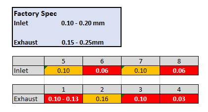

Valve Clearances
Inlet
5 - .1
6 -.06
7 -.1 tight
8 -.06 loose
Outlet
1 - .1 to .13
2 - .16
3 - .1
4 - less than .04
Valve Clearances
Inlet
5 - .1
6 -.06
7 -.1 tight
8 -.06 loose
Outlet
1 - .1 to .13
2 - .16
3 - .1
4 - less than .04

Assuming your measurements are correct you have some work to do. The amber ones below are at "minimum" tolerance and the red are too tight. They should all be at the upper end of the factory spec
