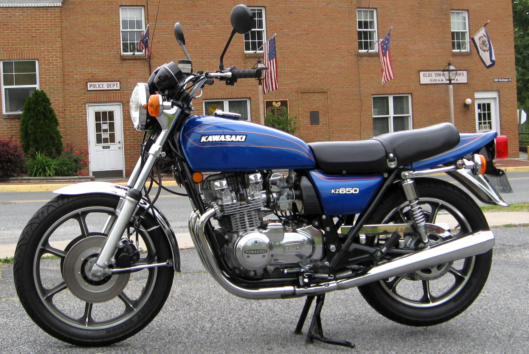

I've owned my 1977 KZ650-C1 since it was new (more than 44 years; 62,000 miles) and have always run unleaded gasoline. No problems. Ed
