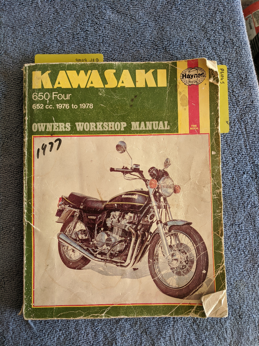

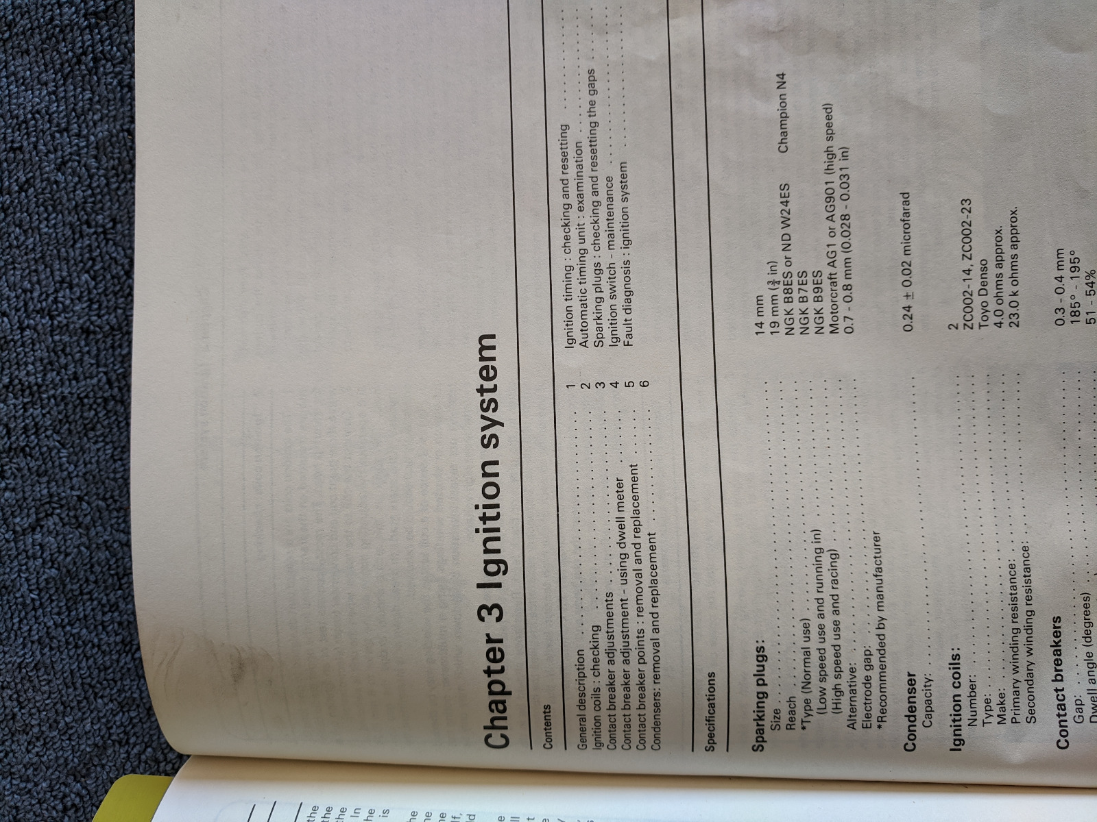

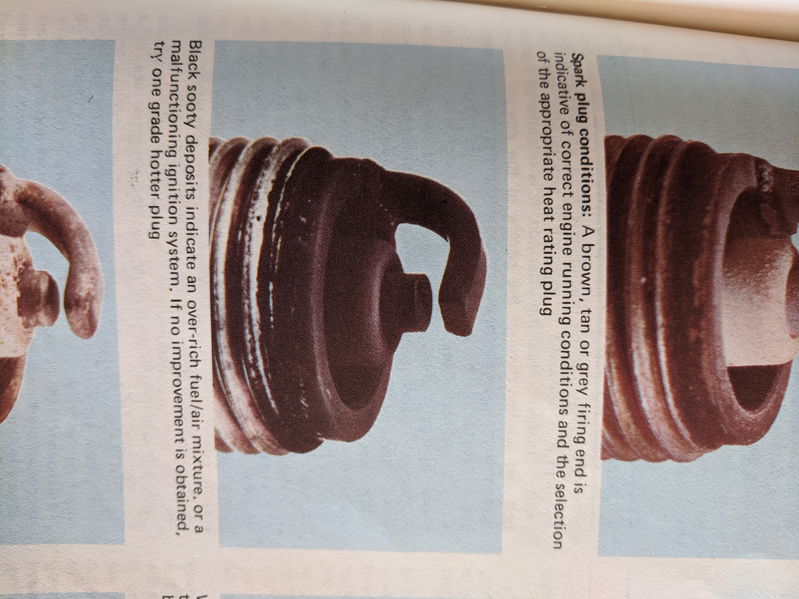

The manual I have:
Plug recommendation:
Advise on sooty Plugs:
This manual has been great so far and I think it aligns with all advise given by you so I don't want to throw it out :)
The manual recommends B8ES but as you've said before, B7ES runs better and the book has this recommendation as well. Problem is I do not have access to any Non - resistor plugs at all. I have called to get them sourced but they aren't stocked in any local store at all, not even online. IF they find them I would have to special order them. Based on researching, non-resistor plugs would be providing better spark but resistor plugs will also work. Because I do not have access to non-resistor plugs, what would you have me do?
That's why I am currently using BR7ES. And, as my screenshot shows above, the sooty plug condition suggests trying a hotter plug and I guess that would be BR6ES. The book doesn't specifically say to use this plug, I am just trying to figure out my next step.

Your Haynes manual copied a mistake regarding spark plugs that was printed in the original version of the KZ650 manual (Kawasaki Shop Manual - Part Number 99931-539-01). That first manual, printed April 20, 1976, recommended NGK B8ES or ND W24ES spark plugs. Those spark plugs may have been ok for racing on the track, but they were too cold for street use. The later Kawasaki Service Manual (Part Number 99924-1001-01) that was printed April 11, 1977, corrected that error and specified NGK B7ES or ND W22ES-U spark plugs. Those are the appropriate spark plugs for the KZ650.

I also still recommend you buy the correct Kawasaki Service Manual (Part Number 99924-1001-01) for your motorcycle and toss out the Haynes manual. If you plan to own the bike you really should own the manual that is specific to your exact model bike. It’s your bike, so do what you think is best, but I’ve owned my 1977 KZ650 for more than 43 years so I have more than a little experience with manuals.
