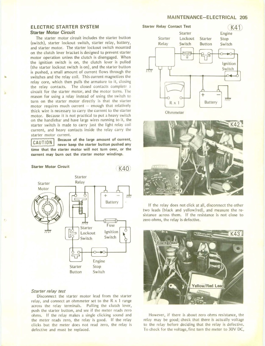

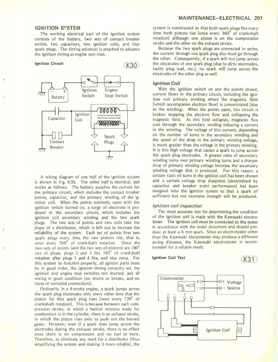

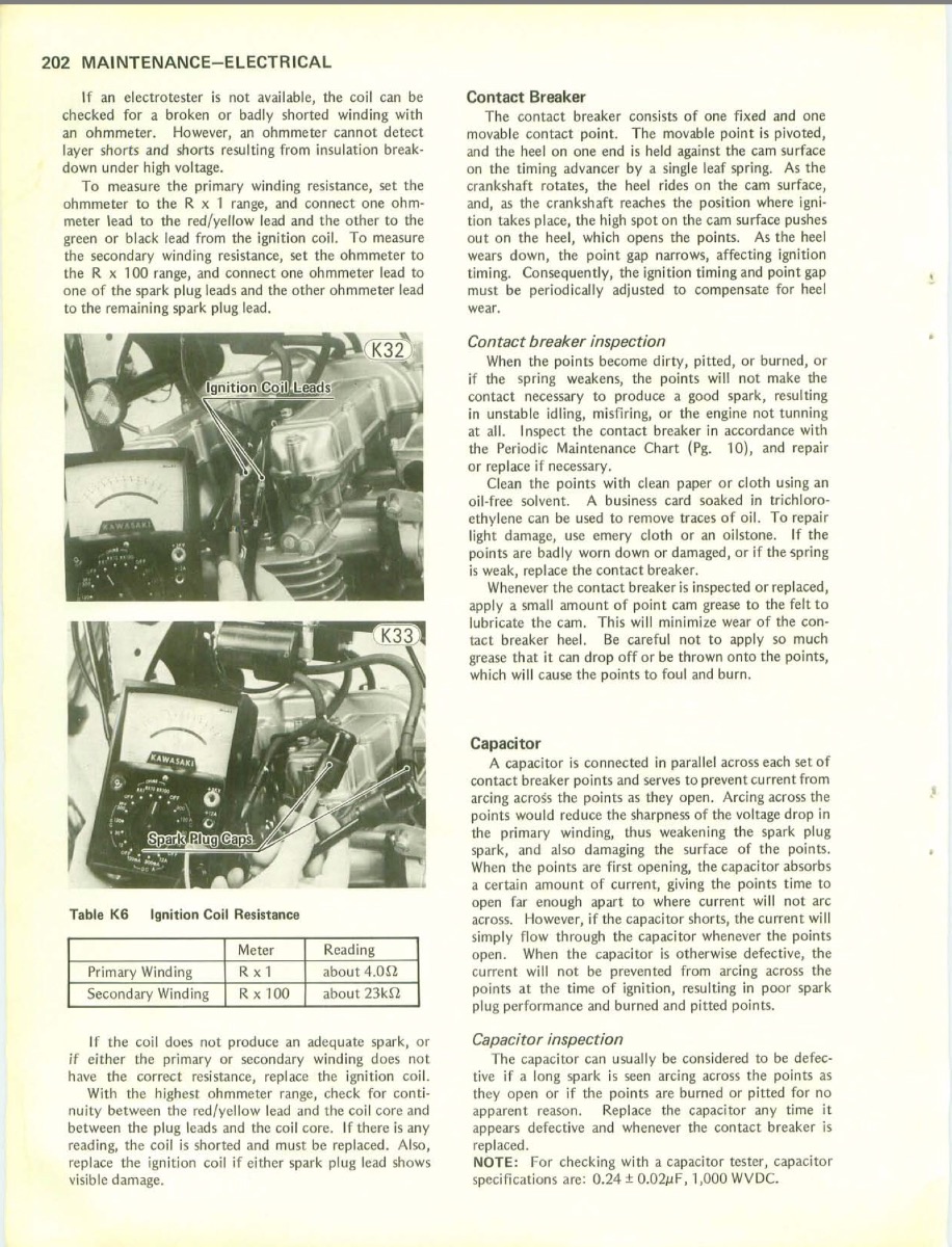

The following is Not your specific year but should help you test the coils and starter

The gas is only a couple weeks old. There's no fire to the spark plugs. Set to 200 my primary tested at 1.5 and set to 200k my secondary (the ones the spark plug wires attach t0) gave me 22.3. The electric start does also work, after some finagling. I also cant loosen what I believe are the drain screws, and I don't know why, but a couple times she has started smoking from somewhere under the gas tank on me.

What sort of finagling makes the starter turn?

I see that you measured 1.5 Ohms across the primary windings of one of your coils. That seems awfully low, even for electronic ignition.
I notice that your meter was set to the 200 scale for the primary reading. It would be better to use a lower scale. Does the meter have a 20 or even 10 scale?
