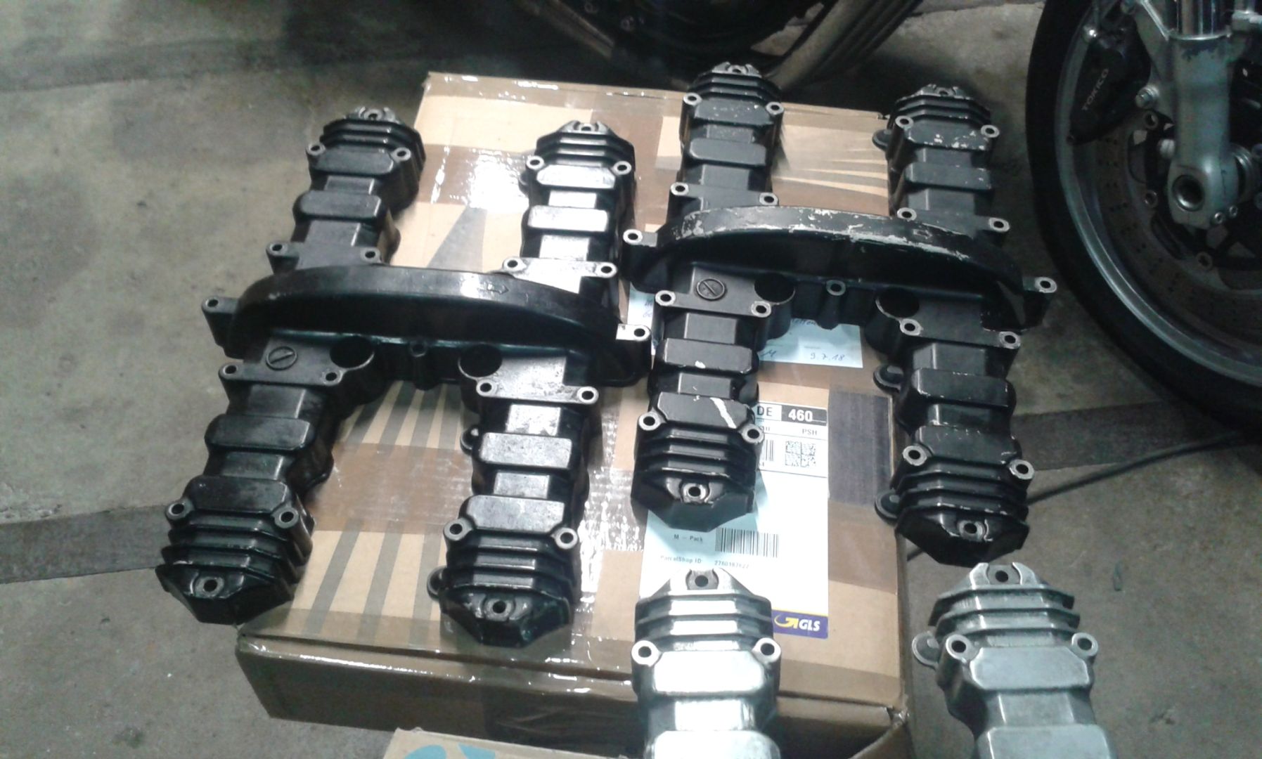

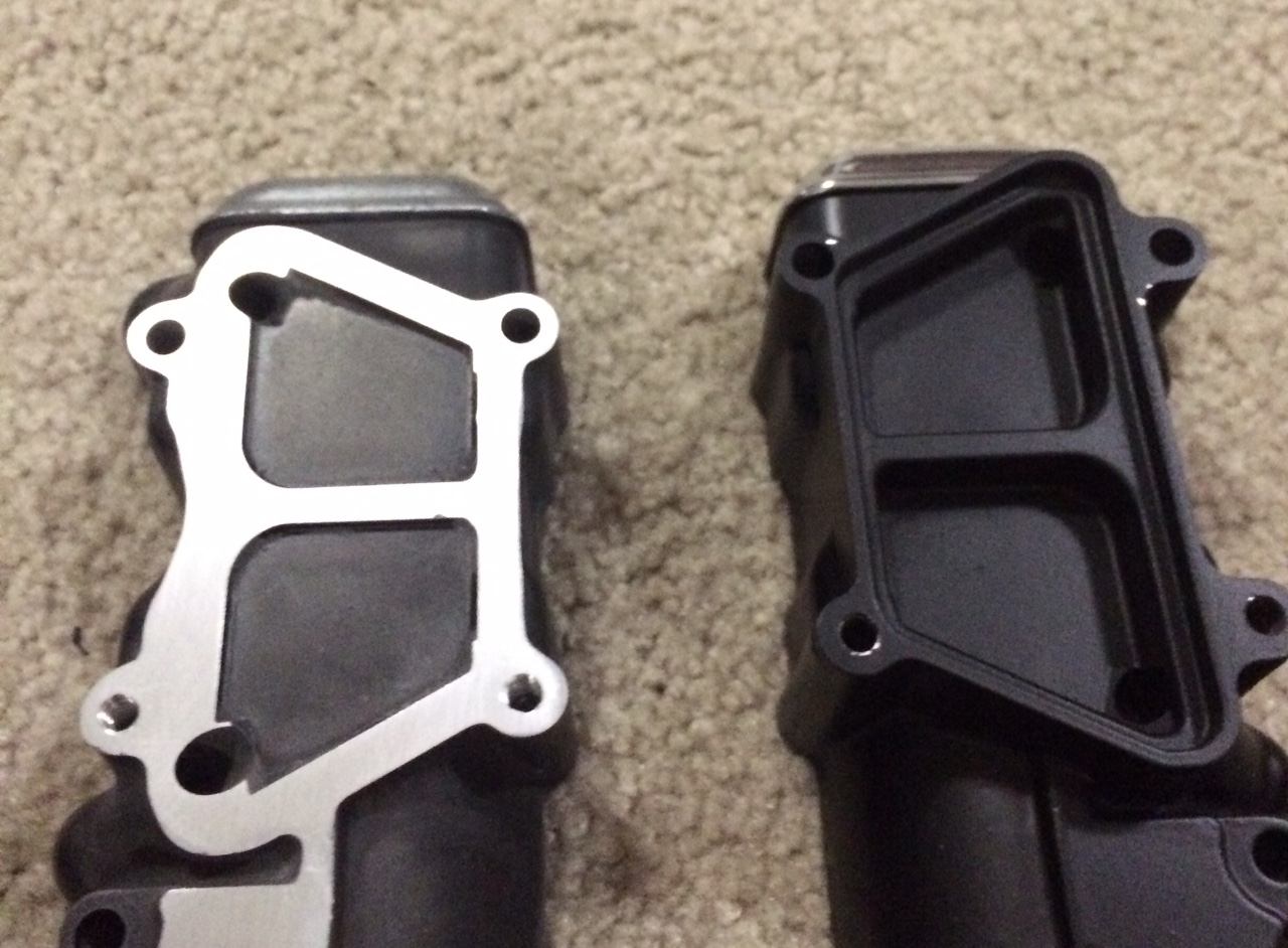

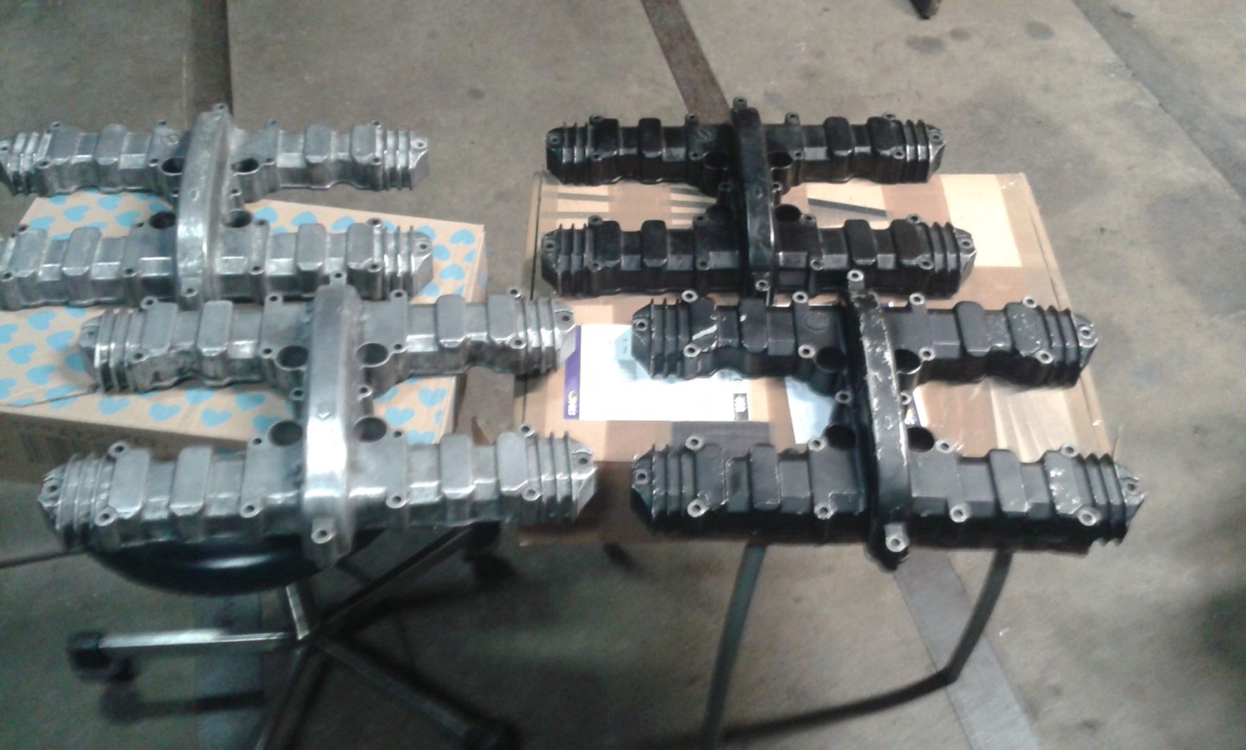

Machined off the unsightly stuff and buffed it up.

I'm workin' on it

This

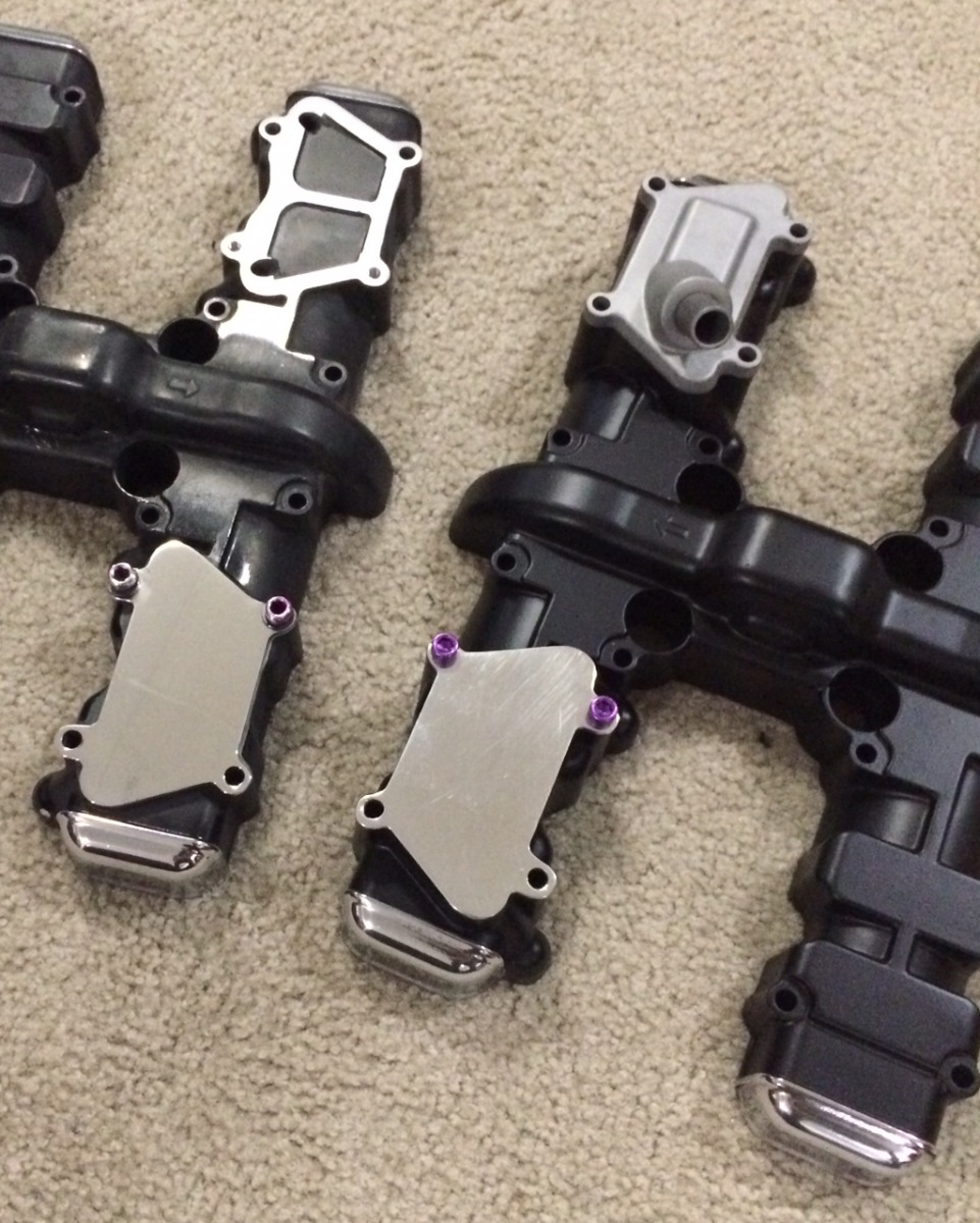

Common mod is blanking off the emissions gubbins.
You could also have converted those to top end engine breathers.

But I want to be different. And that other stuff is expensive and looks like homemade s***.

I plugged them up in the exhaust port, behind the valve, with a 1/4-20 set screw, Red Hightemp Lockight and swaged the threads. If they ever come out,Not, They'll end up in the exhaust .
