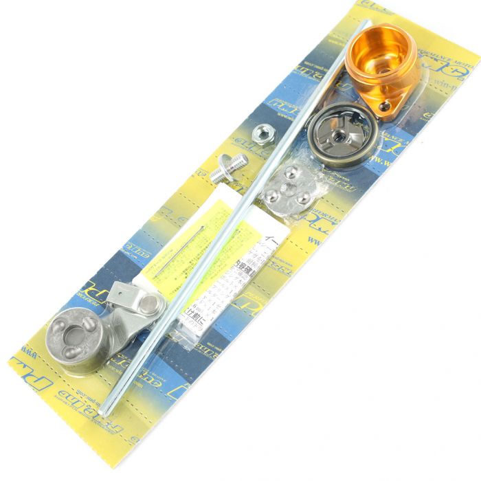

Just installed the easy pull clutch from Z1 Enterprises on my KZ900. Worked as advertised, feels like a hydraulic clutch, smooth and easy pull.

Looks nice! Is it that this device uses a different leverage ratio or is it that the older 900 uses the helix actuator? I had both to choose from when rebuilding my 750 and went with the ball and ramp type like shown here. It works great and has low hand effort like you mention.

I still have the actuator for a 350 honda but none of the other parts. I was planning on adapting it to my bike but then I remembered that dreaded POP sound then no clutch. I would have to take off the sprocket cover to re-orientate it to ride again. Keep us apprised on how it's working for you. Might be more converts. :whistle:

28 Dec 2019 19:38Are you saying the actuator with this kit is the same as the Honda 350 and some times will malfuntion?SWest wrote: I still have the actuator for a 350 honda but none of the other parts. I was planning on adapting it to my bike but then I remembered that dreaded POP sound then no clutch. I would have to take off the sprocket cover to re-orientate it to ride again. Keep us apprised on how it's working for you. Might be more converts. :whistle:

Looks identical. I'll post a pic tomorrow. It worked great until the pop then loose lever. I wonder if they solved that problem with the new aftermarket ones.

Looking closely at how it all goes together I don't see how anything can pop out everything is captured. What kept popping out on the 350 one?

I think it rotated too far and got stuck. We've had some complaints here with the same symptoms.
