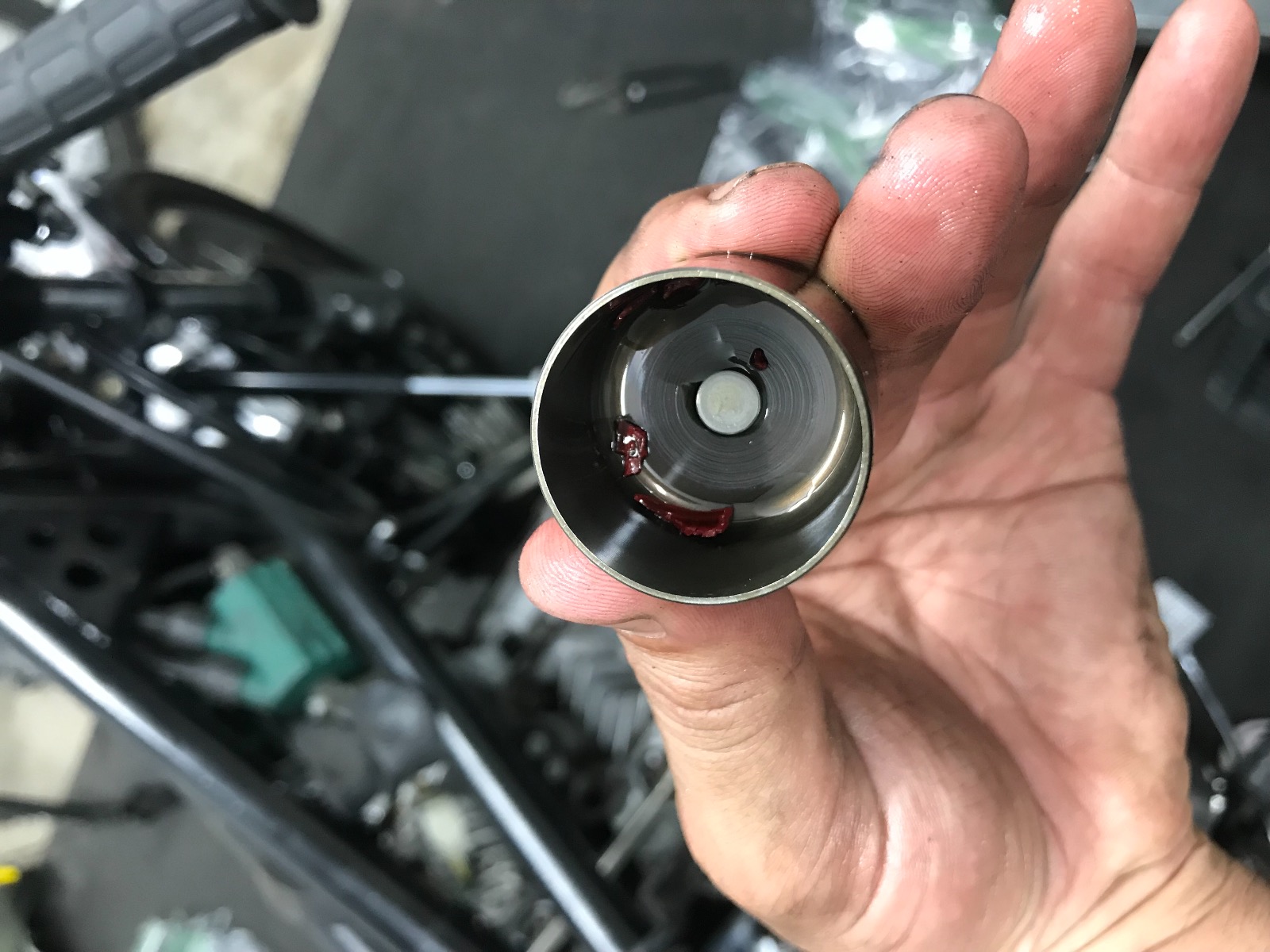

After some more riding through the week, I dumped the oil, and found a ton of ultra fine tiny metal debris around the magnet drain plug.

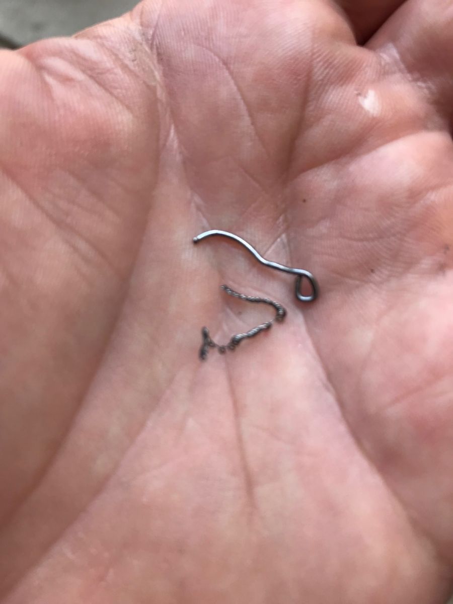

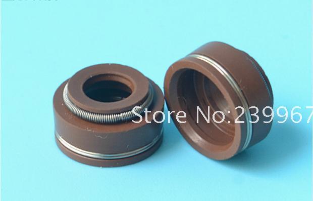

Also there was a weird little piece of metal as seen in the below photo that was in my oil that looks like a paper clip of some sort that got shredded through the motor? WTF. I thought it was a piston wristpin circlip that popped out but nope, all mine are in tact.

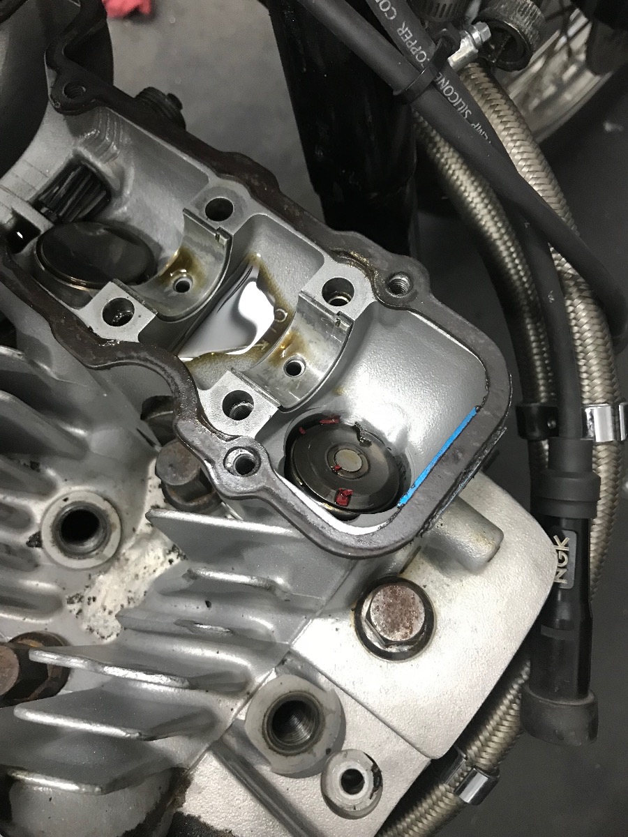

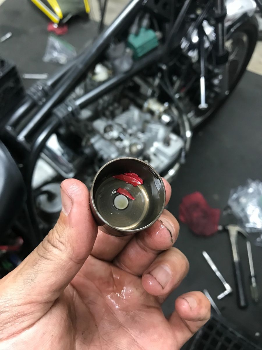

I just took the motor apart. Looks like 2 valve seals exploded. See pics below.
I have the red Viton seals, its def them.
Why would this happen?

Bucket hitting seal because of high lift cams or the seal popping off the guide?

I would think that those two seals were not firmly on the guides and got smashed between the retainer and the guide.

When you get the valves out you should have a better idea. Like if some of the seals are still fastened to the guides but the tops are beat up would suggest a clearance issue. Very curious. Keep us updated.

Looked to me the outside spring retainer got caught on the inside spring somehow.

Anyone have an idea what the paper clip metal thing could possibly be from?

The "paper clip " is the distorted plain metal spring clip that helps retain the seal to the valve guide.
It is clearly seen here In the pic.
Spring for the valve stem at the top and the plain clip for the guide at the bottom.
