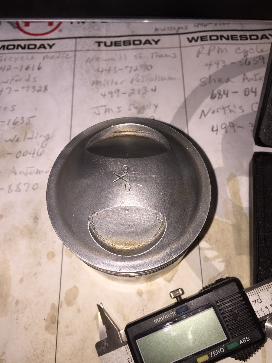

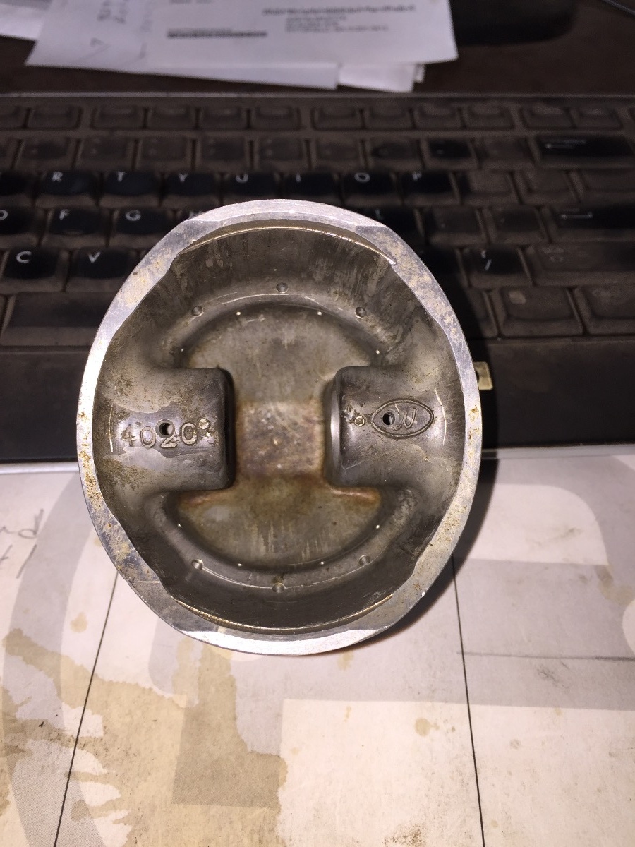

Mine have 3 d with an X between them. 4020 cast into the wrist pin boss on the underside.

I just measured the ring grooves. 1.5mm for 1st and second and about 2.75mm for oil control ring .piston skirt measures 72mm

The 2835XC rings are the correct rings for the 72mm C marked piston so there may be something wrong with either the piston ring groove machining or a mix up with the rings packaging or possibly you have the top and second rings in the wrong grooves as one is thicker than the other ( 1mm and 1.2mm)
The earlier Wiseco pistons used XA rings which are thinner than the XC and the pistons were stamped with an A.
