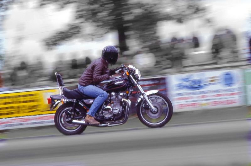

I went with the Yoshimura pipe , They are still offered but pricey. .
AS mentioned here and in other posts of mine building in stages is what I did.
Since I started with a new bike I did some things in different order.
First I replaced the 26mm carbs with 29 smoothbores which made me faster than my buds Z1R with 28s.
He put on Winning pipe / I did the Yoshi pipe to stay in front.
Then we both did 1075 wiseco kits and welded the cranks . ( anytime motors came apart we always installed new HD Cam chains.
From there we did 1200 big blocks and headwork and cams .
Then started over and went turbos as we both crewed on a top fuel bike and knew how to make these bikes fly
But no need for all this / or to do to much just to have fun
Bike in 1980
