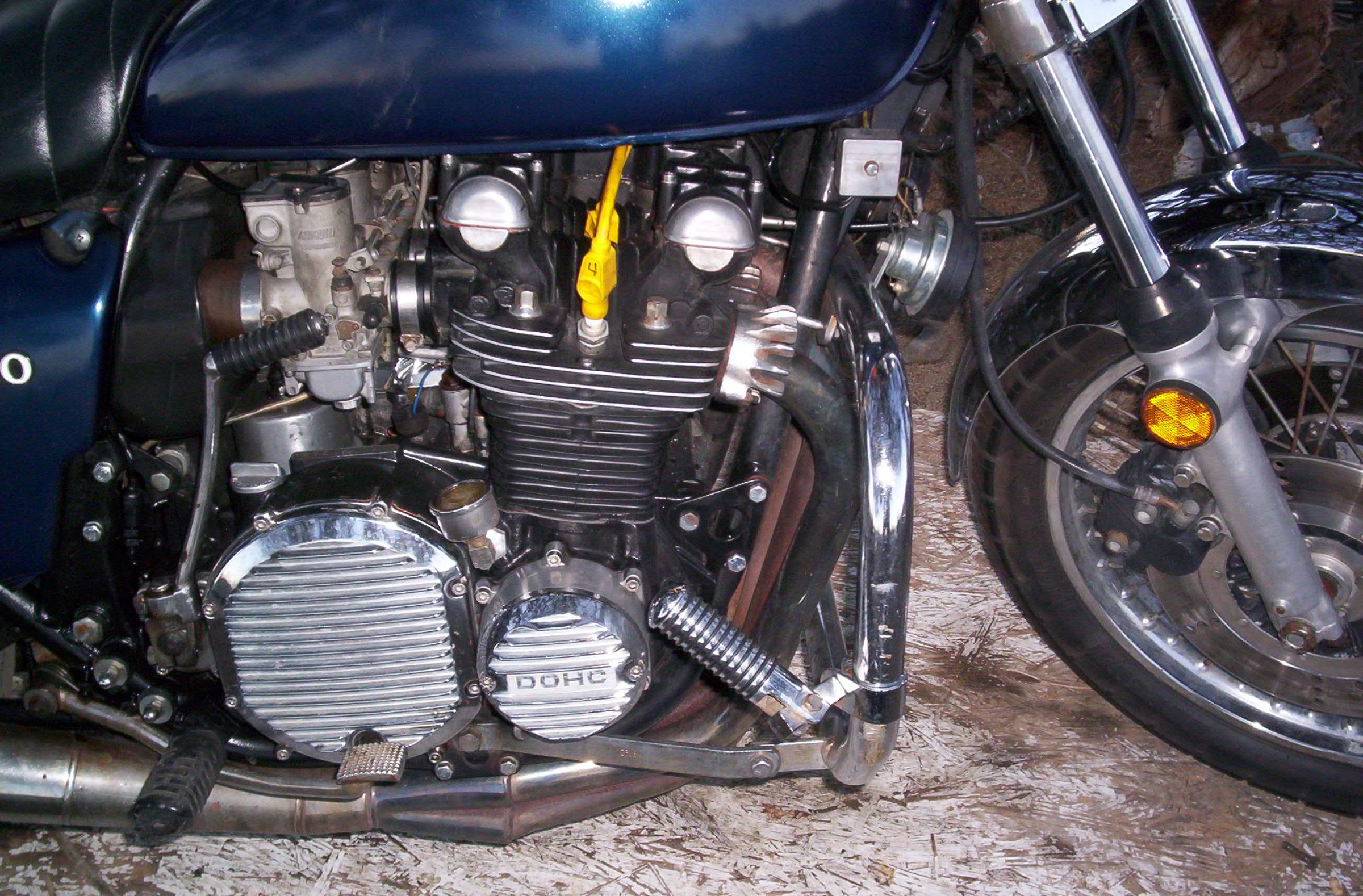

So I got the cover on ,no leaks ,stainless hex bolts with flat and lock for good measure. I started the bike and it was still smoking. figured I had better clean the oil/grease off the engine to see if there is another leak.i used brake cleaner got the grime off and see no visible leaks. The smoke is comming from the manifold?Where the exhaust attaches to the motor. i guess my question now is if your seeing smoke there is this the sign of a bigger problem? I just let the bike warm up ,I was afraid to let it run too long incase it was a bigger problem. Should I let it try to burn off seeing the leak was just above the manifold. Heck I don't even know if it's called a manifold on a bike lol. Thanks in
advance.

Residual oil? Did you adjust the valves while the cover was off?
