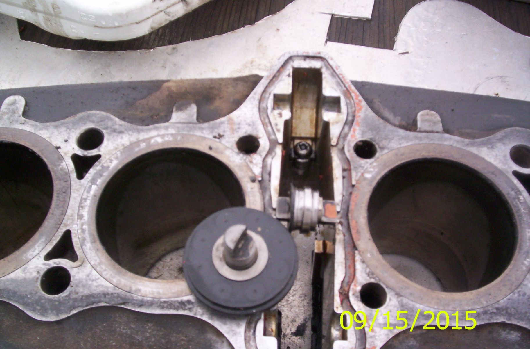

That's a tough one. I had the same thing.
That's the old roller that had been ground up by the cam chain and a new one beside it. Later I was having problems with my clutch. In this clip you can see particles of aluminum on the plates. I think they came from the pressure plate and maybe some from before.
You should check your valves anyway and while you at it inspect the cam chain guides too.
