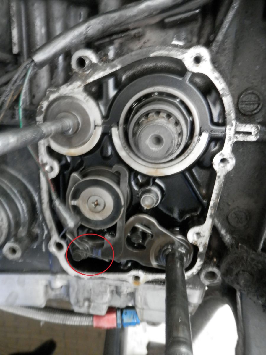

31 Oct 2014 09:26martin_csr wrote: There are a couple of springs for the shifter pedal, so maybe one of those needs replacing. I don't know how difficult it would be to do.
I would follow the advice posted above and hopefully correct positioning of the left hand side cover will fix the problem. If the shifter pedal is still limp then as martin suggested it might be a spring and you might need to dig a bit deeper. If you take off the left side cover and then the front sprocket you can get at the transmission cover (at least I think thats what its called. I had to take that cover off recently to check the output shaft bearing and luckily took a photo which you can see below,
You can identify the output shaft, the clutch pushrod and the gear shift pedal in the photo. See the mechanism which is moved by the shift pedal ? I circled the spring in red. I am honestly not sure if a broken spring here will cause a limp shifter pedal but it might be worth checking if you cant find a solution in the outer cover clutch mechanism

the spring to check is behind the shift shaft .

01 Nov 2014 09:51kawi810 wrote: the spring to check is behind the shift shaft .
Is that spring accessible in the pic I posted above ? or is it inside the gearbox proper and accessible after removing the oil pan ?....... just in case I ever need to look for it

The middle shaft is what the warning is about. Don't pull it out. You'll have to split the cases to fix it. The shift return spring is behind the shifter shaft at the bottom. The gear select is to the left. The drum is held together by the screw. Make sure it's tight. The Kaws have a feature that prevents shifting when the bike is not moving. That is to prevent up shifting from neutral at a stop. That's not a problem. Spin the wheel and it should shift as normal.
