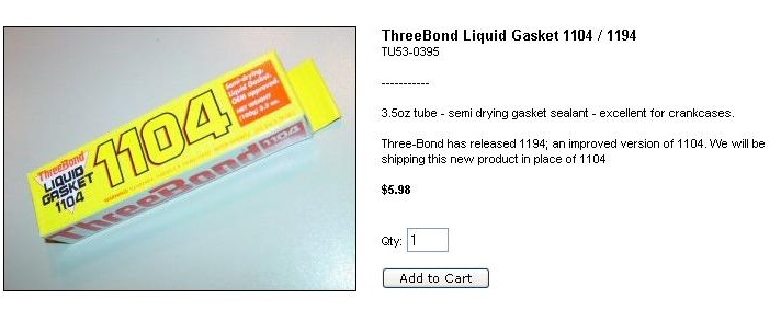

Since it works on engine cases and thinner than RTV.... ;)

Old Man Rock wrote: Since it works on engine cases and thinner than RTV.... ;)
OMR (or anyone else), what else can you using this on? Is the base gasket for the jugs required or can I replace it with a gasket maker? I have a gasket but I'm not sure its a good one; it came in a kit I bought from Japan(D&K and its green). Keep in mind this is a stock motor with the exception of pipe and Henry Abe bread box air filter.

DO NOT use sealant for the base gasket. It is a pain to replace a leaky base gasket so just get a new one.
